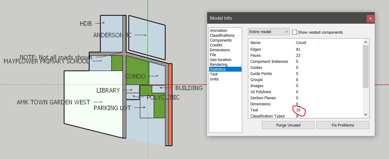

In the image below there are 13 pieces of text in the model, however there are only 10 visible in the model space. That probably means there are 3 pieces of text or leaders floating around somewhere causing the camera to behave strangely.
I tried to find and delete the 3 pieces, to no avail. What I then did were selected all the model and copy/pasted it into a new file, with the urban planning template you mention. Hoping I wouldn’t take the 3 stray pieces with it.
The shot below shows now only 10 pieces of text in the model statistics and 1 less edge that I think must have been floating too. The model appears to be behaving in a more normal way.
