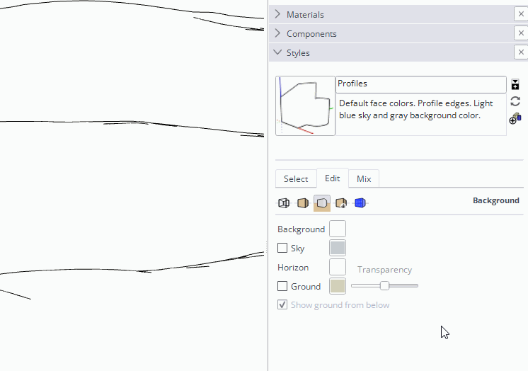

Thank you Dave, no I don’t really want the background.
This reveals it is a face issue? The style is hidden line, faces are #ffffff anyway.
I am at an absolute loss.

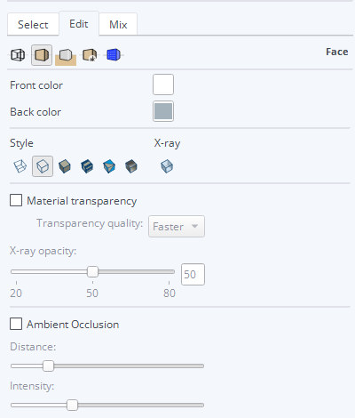

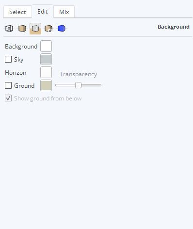

What color do you want the faces? The Hidden Line style doesn’t really show faces but it picks up the color from the Background color in the style.
I don’t want the faces a colour at all, hence hidden lines and background being pure white.

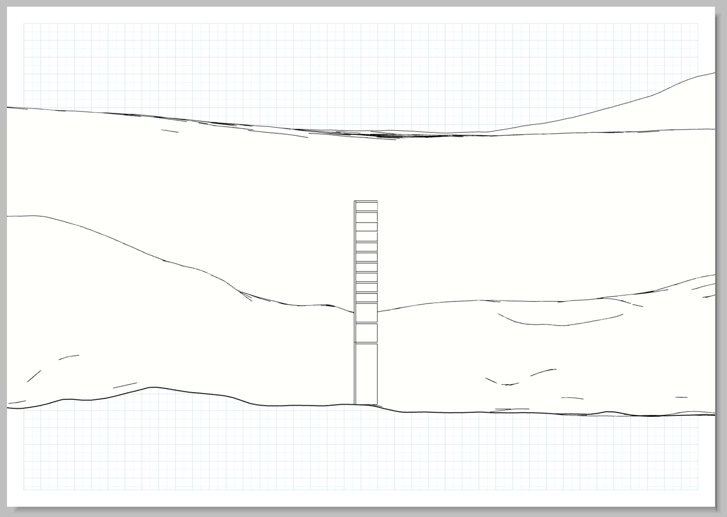

I just want pure white. It’s worked on the shadows page but not on this. When I go and multiply this layer over in Photoshop I end up with a slight yellow because of it.

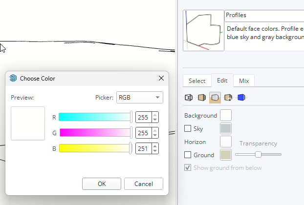

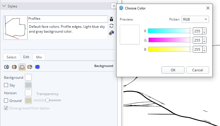

Are you certain the background color for that style is set to white? RGB 255,255,255.
Looking at the background color in the model you shared shows it should be slightly yellow.
backgnd
That is weird, in my file I have it set to pure white

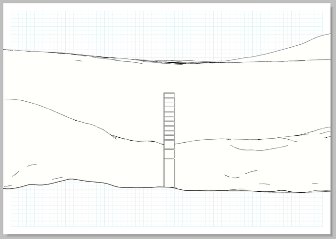

I keep resaving, refreshing the model connection, re rendering and getting what must be that 255,255,251.
Does the Styles panel show that the style has been overridden for the viewport? Is there a Reset button in the Style section? If so, click on it to allow the viewport to update to match the SketchUp model.
Thank you so so so much!

Update if anyone else ends up finding this thread for similar issues:
For some reason, I now have to have separate scenes for each style. If I don’t, regardless, the colour is changing in the viewport and there is no option to reset.
