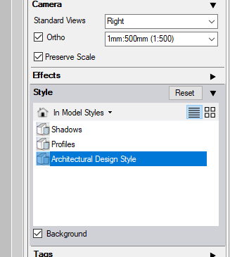

In SketchUp I happily have my 2 styles. Refresh (Not sure if this is the correct term but the 2 arrows) and it shows the 2 styles. However, whenever I click one, it goes and adds “Architectural Design Stye” to the list in LayOut (not in SketchUp) and refuses to let me click either of the other styles, defaulting to this and reverting to “profiles” and “profiles1” whereas the styles in SketchUp are “profiles” and “shadows”
Here, my mouse is clicking “shadows” but instead “architectural design style” gets applied?

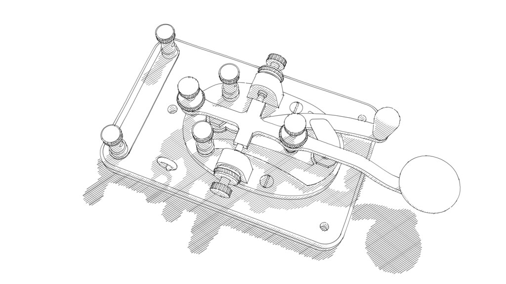

I regularly stack image exports directly from SketchUp. This was an experimental one. I’m not so fond of the shadows here but …

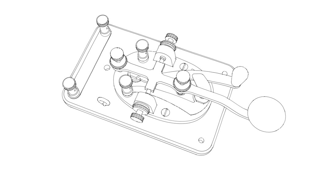

A hidden line export with a sketchy edge style.

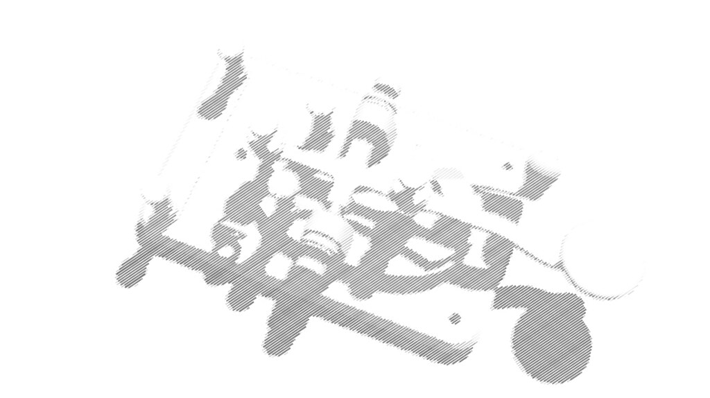

Shadows only export that was then run through Fotosketcher.

Sometimes I will end up with 3 or 4 or 5 exports from SketchUp. Easy to control line weight in the exports.

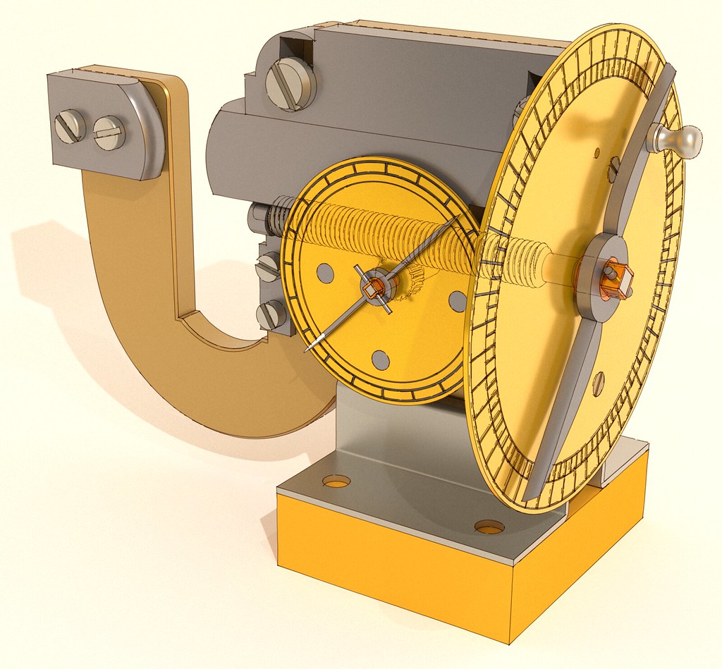

This is another combination image.
This can be faster than waiting for LayOut to render viewports, too.
These wouldn’t be to scale though will they if they’re 2d exports from SketchUp?
That’s odd. Is the Architectural Design Style included in the SketchUp model? If you aren’t using that style for any of the scenes in your model, purge it from the In Model styles.
You should be able to select whichever style you want for the viewport in LO. I wonder if @Barry might have some insight into why you can’t change the style.

No it isn’t. I just went through and cleared all the styles and remade the 2 I needed. Very annoying. Here my cursor is on “shadows” yet “Architectural design style” is added again and selected.

I wonder if the style is coming in through your LayOut template. There probably has to exist at least one style that LayOut can assign to model viewports.
I used the “A3” blank template.
Even if I did have this style intentionally, I don’t see why it wouldn’t let me select the other 2. I click on any other style and it highlights the “Architectural design style” one instead.
We did fix a style bloating-file-size bug for 2025.0.2 that was introduced in 2025 and 2025.0.1, but that would let you change styles. Just make sure you’re on 2025.0.2 (latest).

I am on Layout version 2025.0.571. Is this older than 2025.0.2?
25.0.634 is 2025.0.2 on Windows.
I was able to change the style in your file. It is a little slow due to all the geometry but it did change.

Weird, I can’t even click it. Hopefully, updating fixes all this.

Updated and it works! Hopefully this is the final headache with LayOut but I am doubtful…
Still got the extra style though…
