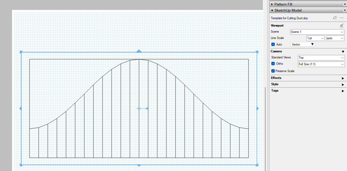

OK. In the SketchUp file you haven’t created a scene for the view you want and in your LayOut file you’ve modified the Camera properties from the SketchUp model. Note the Last saved SketchUp view and the Reset button in the Camera section of the SketchUp Model panel.
Resetting the camera shows you haven’t set the camera to Parallel Projection.
I set up your SketchUp file with a scene showing the model as needed with the appropriate standard view and Parallel Projection. Then I relinked the reference in LayOut to the saved file, reset the Camera and set the scale as desired. I also set the style for the scene to Hidden Line so there wouldn’t be all the color to print.
Here’s the LayOut file. You can extract the SketchUp model by right clicking on the viewport and selecting Open with SketchUp.
As for printing it, first use File>Export>PDF. Export a PDF file and open it in Acrobat or Reader and print from there. Unless you have access to a large format printer you’ll want to use the Poster Print option in Acrobat or Reader to print this thing. You could also email the PDF to a print shop for printing, too.
Based on the height of this you could choose a custom paper size in Document Setup>Paper to reduce the number of sheets used in poster printing.

I printed this out then started to put it together yesterday. It was too big. I counted the pages and there were 24. The print menu in Reader says 10 which is what the preview screen shows. Measuring the image on the template, it is 50" wide. It should be 37 11/16. Other settings look the same as on your screenshot. It is as if the printer is scaling it up? Any ideas?
Can you show the print settings in Adobe Reader? How much overlap did you set? This is what I see in Reader’s Print settings. This is using the smaller paper version.
Maybe you should send the PDF to a local office supply shop that can print it on one sheet.
My print settings look the same as yours. I went into my printer properties and saw options for borderless printing. I checked those options and it seems to be working now. It is doing 10 pages now. I need to put it together and measure it. Thanks again! I will let you know how it goes.
Ah, borderless printing would be required. Good that you got the settings workedout.
