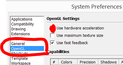

If your print is a wireframe image even if you see faces and textures on your screen, your display driver has deficient OpenGL support. You should try updating the driver, or, as a workaround, uncheck “Use Hardware acceleration” from the Window menu>PreferencesOpenGL dialog and restart SketchUp before printing.

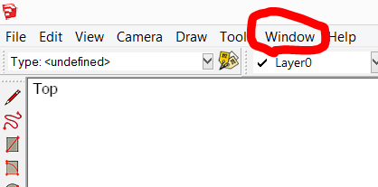

You should be able to print OK if you open the Window menu and click on Preferences
Then, in Preferences, click on the “OpenGL” text on the left, and on the right, remove the checkmark from “Use hardware acceleration”. Then click OK.
Finally, close SketchUp and reopen it. Now you should be able to print, but zooming and orbiting in complex 3D models might feel slower.
