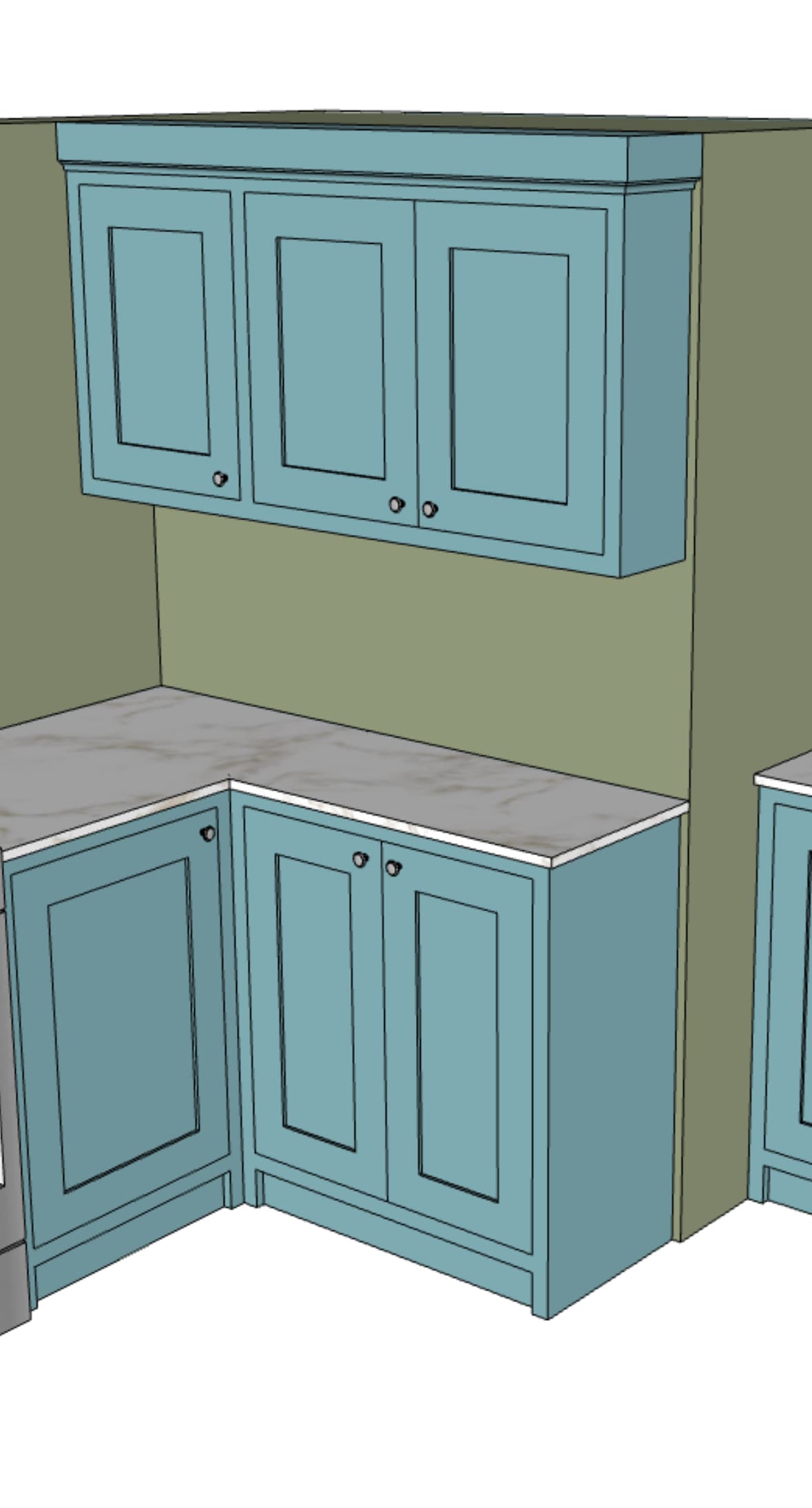

I have been using SketchUp for Web for the past 3 years with no problems at all. I use it for designing bespoke kitchens etc. I had created some drawings, downloaded them fine and had to come back to amend the drawings. Now when I download the image is blurred and isn’t as crisp.
Just wondering if that’s a new update to encourage people to buy a SketchUp subscription or whether it is a problem with my laptop? I did have a message pop up saying it recommends me using an external graphics card. It’s not just on this one drawing, I tried just drawing a rectangle and that still didn’t download properly.
Any advise would be greatly appreciated. I’ve attached a photos of my current situation.

an example of how it used to download for me.
The pixelation you show looks like a graphics artifact.
I expect the message you saw actually indicated that a discrete graphics card is recommended over an intgrated one.
Probably the latter, not the former. You could try updating the graphics drivers for whatever graphics card you have and see if that helps.

Technically, from the images you posted, the first “pixelated” one would indicate that the display didn’t use any “antialiasing” while the second has some level of antialiasing turned on. I don’t know how this could be managed from within the Web version of SketchUp. Did you use SketchUp through the same Internet browser for both images?
Yes the drawings were still open on the same browser when I made the adjustments.
