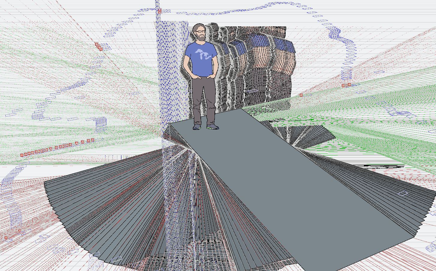

I’ve been using SketchUp Pro 2015 with Shaderlight for a few years; the program worked fine. I had to download SketchUp Pro 2019 yesterday to my new computer. The program is completely unresponsive to key commands, none of the tools work. I’ve uninstalled the program from my computer three times and have reinstalled the same number of times with the same problems. No error message. I’ve uploaded a few screenshots that show what happens when I just move the cursor around. I may not be as knowledgeable about hardware as some but I’ve used SketchUp long enough to know what it is supposed to do. I just paid for full access to a program that I can’t use and am having to resort to using the online version just to get some work done. Can somebody please tell me what is going on and why this download is corrupt and what I can do about it.
Your screen shots indicate that the graphics card isn’t supporting OpenGL properly. Not uncommon with the GPU indicated in your profile. Try Window>Preferences>OpenGL. Untick Use Fast Feedback.

There is a chance that Dave is wrong about the unticking use fast feedback. Older versions of SketchUp would believe the claims of the graphics cards, and would have that option checked. But, on Surface Pro in particular having that option checked would give you a blank document. Support received hundreds of emails and phone calls that were all the same symptom and same solution; unchecking that box.
With 2019.3 things were changed, and if you have an Intel integrated GPU, SketchUp now sets that box to be unchecked. That will cut down the number of support tickets from Surface Pro users.
Unfortunately, there are Intel GPUs that are more capable, and unchecking that box leads to a new symptom, where you get all of those crazy lines. Checking the use fast feedback box fixes that.
The general case is that if you see something that is graphically wrong, toggle the state of that box, from what it is now, to the opposite of what it is.
