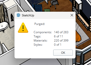

I purged unused content. Seems you’re hoarding a lot of components and materials.
There’s no point in keeping stuff you aren’t using. That just reduces performance.
