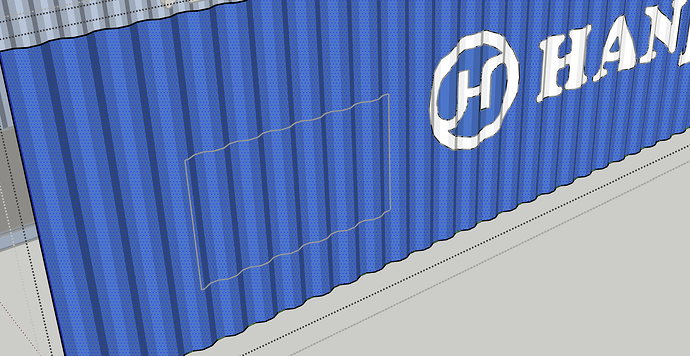

Thank you for your help Dave! I can do everything up until selecting the area inside the outline. For some reason, I can’t seem to select solely the area inside. It still only highlights the entire component and appears to grey out the outline. I even tried doing it with the same container you provided in the example.
Not sure if you can see that screenshot but I am unable then to select just inside. Am I missing something? This is so frustrating because once I get this down I can go on with my project. Thank you again for trying to help!
You didn’t get the cutter shape inside the side component. It was still outside of that component. Other than the fact that you can’t select the region inside the outline, the heavy profile edges are a clue that you didin’t burrow all the way in to the geometry of the side. Also when you finally do open the side component to access the surface, the outline from the cutter is grayed out indicating those edges are outside of the component.
Must I do anything before I extrude the cutter shape? I created the cutter shape, push/pulled it through the container wall, selected intersect by selection, erased the cutter shape faces, and that is where I took the screenshot. Is there anything I was supposed to do beforehand? Such as editing the preexisting component or exploding the component? Apologies if this isn’t the correct terminology or questions I should be asking. I am still learning. Thank you!
Yes. Open the component containing the geometry for the side before drawing the rectangle so that the geometry of the cutter will intersect with the surface of the side. Without that the “cutter” is outside of the component and won’t affect the geometry inside the component.
Don’t explode the component. That can result in the geometry inside the component merging with other geometry that you don’t want it to merge with.
