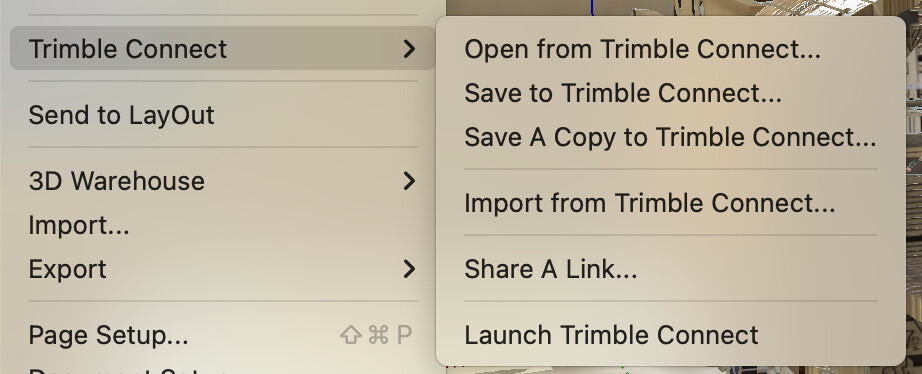

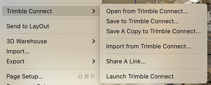

Trimble Connect does have a lot of collaboration features that are more than you are asking for. But, if you happen to have saved the model in Trimble Connect, a new feature in SketchUp would let you give a link to someone for them to view your model. They do not have to go to Trimble Connect.
This article shows how the feature works:
https://help.sketchup.com/en/sketchup-web/link-sharing
In SketchUp the new feature has this icon:
Or you can get it from the File menu, in the Trimble Connect section:
Here is an example link, for one of my models:
