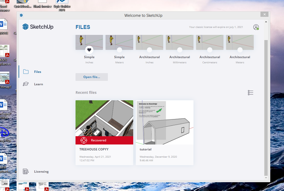

I did it. Now my SketchUp program says “recovered” on top of my drawing.
What exactly does that mean?
I assume you are talking about the Treehouse file? That means that SketchUp is presenting you with the option to open the recovered version which should be the last saved version. Go ahead and click on it and open it. Then immediately save it. After that, do the Purge Unused thing.
I opened the “recovered” version and none of my progress was deleted!
I did the Purge Unused thing, and my statistics went from…
