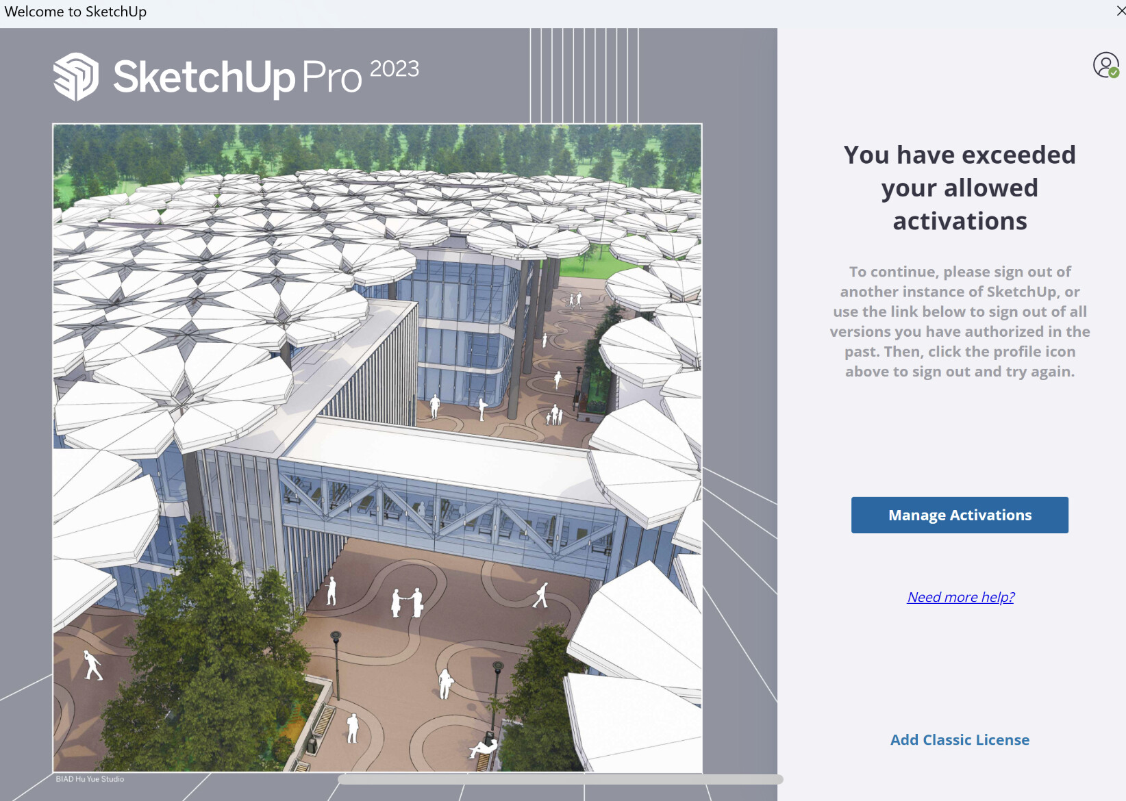

Show a screen shot of what you are seeing.
Why does it say that… I purchased sketch up pro I think. But it’s not opening.
So you do not have SketchUp for Schools. You are showing that you have SketchUp Studio. Please correct that and fix the rest of your forum profile.
It shows that you have zero seats available out of the one you purchased. Did you have SketchUp open on another machine? If so, you need to sign out on that one.

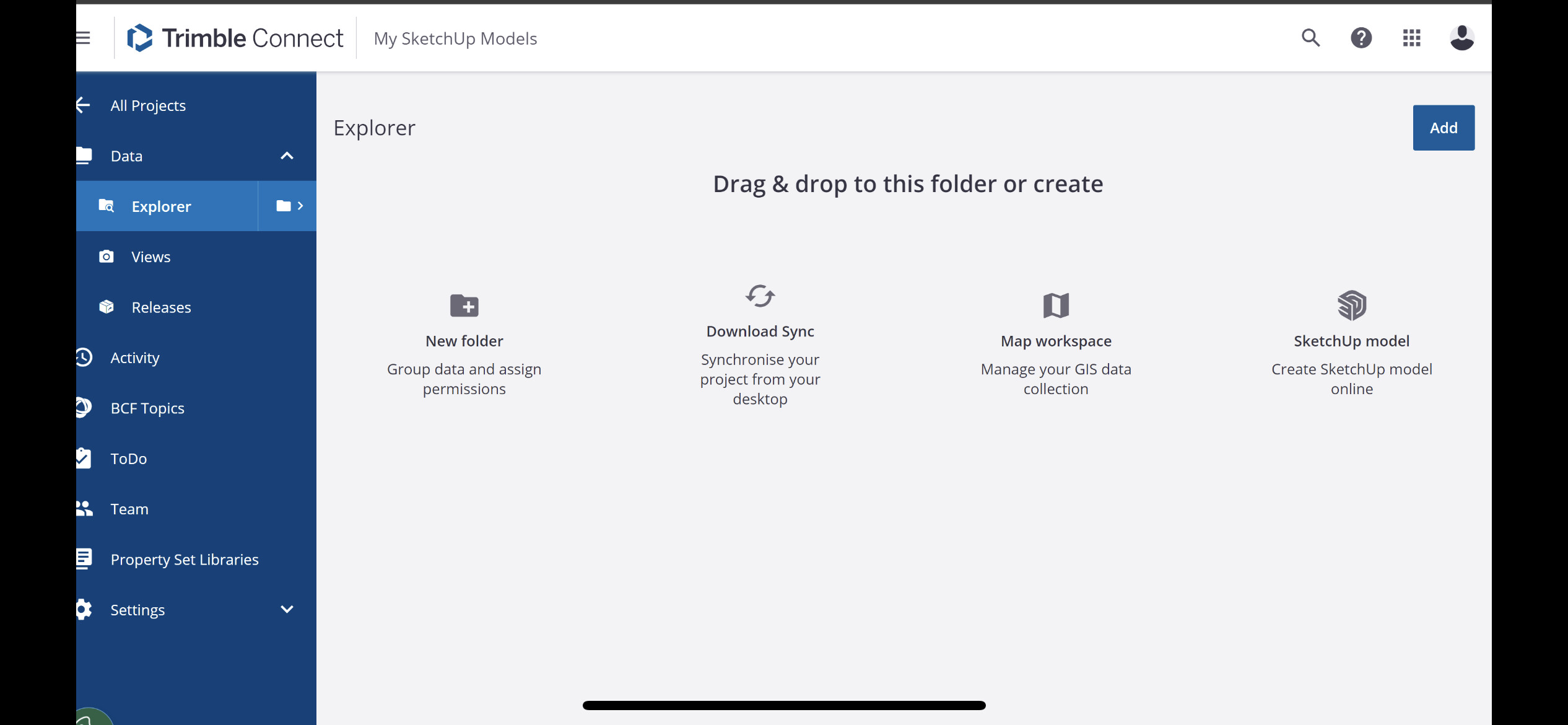

Should I click on that icon image?

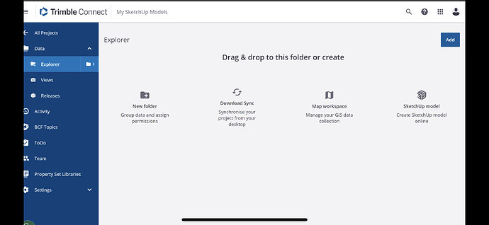

This is what shows me when I click on it
At the top right you should see person icon. Click on that and then My Trimble Subscriptions.

The subscription looks ok. I think that only the signing out and signing in again steps were missed. almanea is typing as I say this, hopefully there’s good news.
After deauthorizing your devices, open Sketchup, if you are prompted with the “you have exceeded your allowed activations” screen, click the little icon at the upper right of the window and log out, then log back in.
