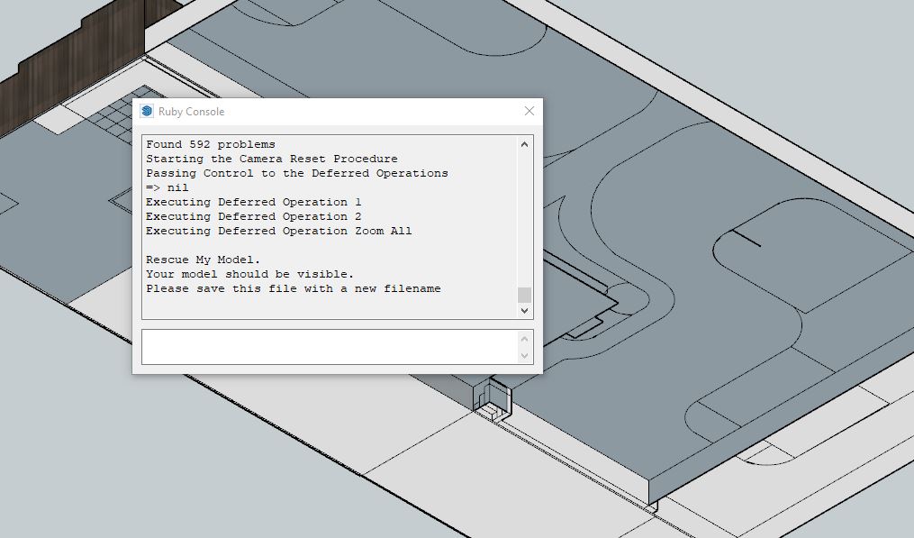

I have looked at the other questions people have posted and tried zoom extents, tried to seek out the hidden geometries and I cannot find a solution. It just looks blank. Any idea what’s happened to my model?? (my file is too big to post here)
you will need to find someplace that can host it and share a link… otherwise we are just guessing at what it MIGHT be that is causing the issue.
Some people use WeTransfer.
Thank you for the suggestion! here is the link WeTransfer - Send Large Files & Share Photos Online - Up to 2GB Free
I’m seeing a lot of components and a number of custom textures all contributing to the overall size, but I can’t find anything modeled from them.
Have you saved it to Trimble Connect as well as your desktop? If so, try going through the version history.
I see. So should I re-start at this point? I have not tried Trimble connect before an have been downloading them to my laptop only.
Basics of SketchUp at learn.sketchup.com
- learn about groups and tags
- learn about Purge
Keep your geometry close to Origin
Check the models you insert from 3D Warehouse
Thank you so much! After this I will defiantly be looking to educate myself better ![]()
