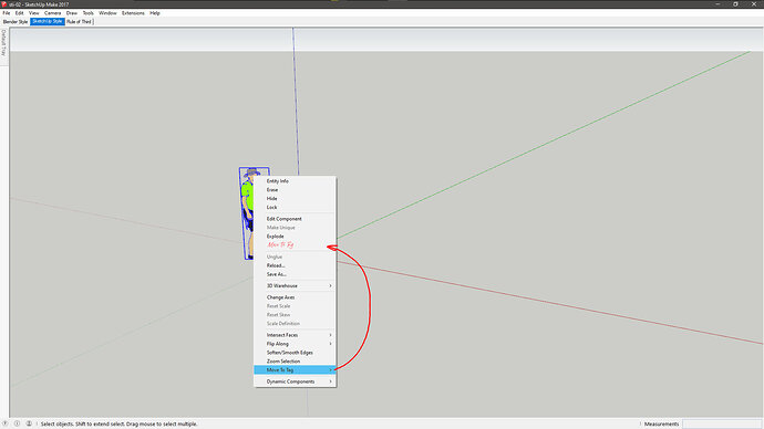

Thank you for the extension, simple, useful and works in SU Make 2017 and SU 2022 (Windows 10)!
Just in case :wink:
  1. Shortcut to ‘Move to Tag’ and only the list of tags to choose from will appear
  2. Mouse scroll wheel instead of clicking on the arrow when the tag list doesn’t fit on the screen
  3. If point 1 is difficult to solve, it may be possible to position the extension in the right-click list at the top
Again, thanks for the extension!
(1) Would need to be implemented as a UI::HtmlDialog with a list of clickable tags.
(2) Is platform dependent for context menus. It is not exposed to the SketchUp Ruby API.
(3) Positioning of menu commands is also platform dependent. It was doable on MS Windows using an undocumented original position 2nd argument with the Sketchup::Menu#add_item method. I am not sure if it still works since the migration to the Qt GUI library.
