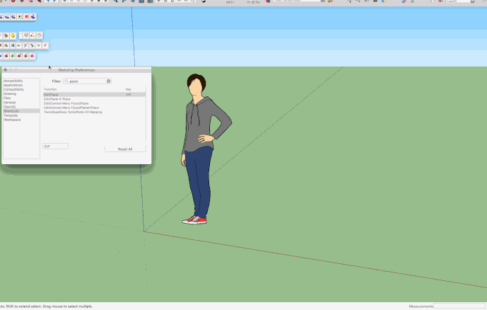

There is a small ruby script in the post that you can download. Once downloaded, you can drag it in the plugin folder of SketchUp (On Mac: /Users/USERNAME/Library/Application Support/SketchUp 2018)
No, the Ruby just contains a conditional to invoke via a command number on Windows vs a named symbol on Mac (if that goes over your head, donât worry about it).
Mike, Iâm just trying to work out what you did in the second GIF. Looks like you created a shortcut first. Then you selected the Stacey component, right-clicked, selected Paste, and created the first copy. You then repeated that to create the second copy. Then you seem to stop right clicking, maybe because you were using the shortcut you created. Is that right? Were you doing anything else on the keyboard I couldnât see?
Because you were using Paste to copy, I thought I would try that. If you use Cmd-C to copy and Cmd-V to paste, it seems to work just like the native move and copy command except that you have to hit two keys instead of one. You can do that without adding any new script. This makes me think I am missing something because having to hit two keys rather than one would be a backward step!
OK. So at what point were you able to stop invoking the shortcut? Was that after the second copy of Stacey? I presume it must be because if you had to invoke for each iteration, you would be back to square one.
Once the item is on the clipboard, you are free to go with the shortcut or the rightclick contextmenu.
The shortcut is faster, offcourse.
Depending on its usage, you might wanna check SkatterâŚ
Mike, I remain puzzled. I can see that the shortcut is faster than the rightclick but is it any faster than the native option of hitting the Alt key using Move?
I remain puzzled as well. The thing is, there has to be an interaction with the UI of the software: You want to place a copy of an object in the model or an object somewhere in the model. This can be done with component-objects by âdraggingâ it out of the Component Panel, allready. (It is actually a âMoveâ action with the copy-modifier always toggled on)
Since the last method only applies to Component-objects, the Ruby snippet provides a method to Copy/paste all types of objects.
Just showing possible methods for implementing the FR. Off course, you can Ruby almost anything, so most of the FRâs would not make it to be implementedâŚ
