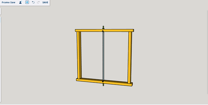

Frame Saw #1.skp (122.8 KB)
Traditionally used by two workers, it can be used by one in tandem with a Bow saw. If one user saws, it should only be where the saw kerfs can be observed. Any unobserved saw kerfs will not stay on course. That means there’s a lot of flipping to carefully rip.
Frame Saw #2.skp (129.6 KB)
See if you can find the changes I made.
