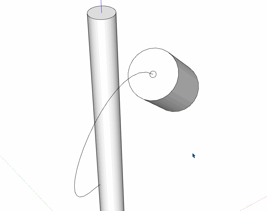

Any recommendations on how I can model the sape of the wire as per image below. Bezier spline and native arc tools have been a nightmare so far.

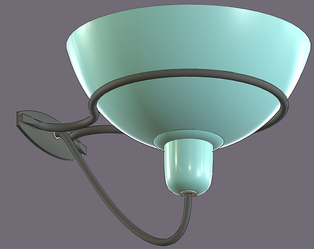

Why? What happens? I would draw a curve for that with either Bezier Spline or Fredo Spline and use Follow Me with a circular profile. The cord on this lamp was modeled that way.

I would recommend drawing a flat plane to draw on. Then use arc or a bezier tool to draw the shape of the wire. Next, erase the rest of the plane and use Follow Me to send a circle along the new line.
