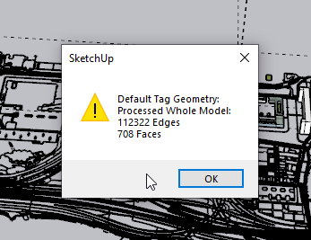

It would also be a good idea to fix the incorrect tag usage from the imported CAD file before you get too far in. I used a plugin called Default Tag Geometry from Sketchucation that fixes that automatically.

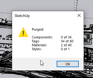

And purge unused stuff regularly to help keep file size in control.
