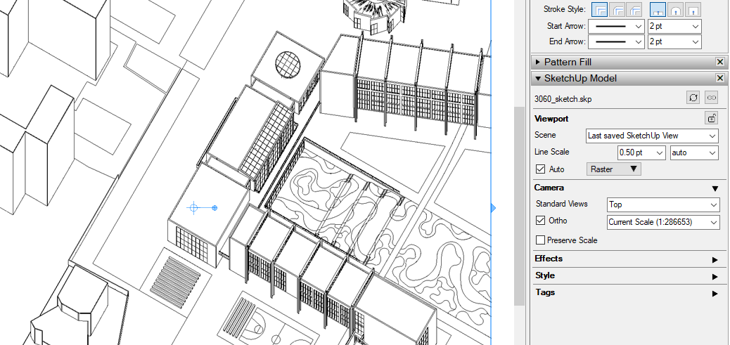

Hello! Im trying to scale a Sketchup model in Layout, but when i choose the scale, the model dissapears. I already tried enlarging the viewport but there´s no way I can find it!
I´ve seen people with similar issues, is there any other solution?

Part of the problem is you need to have set up a scene in the SketchUp model to use for the viewport in LayOut. Using Last saved SketchUp view creates huge problems if you have to go back to the SketchUp file to make edits or adjustments.

How do we set the scene for the viewport? We have a scene created but we dont know how to link it into Layout, its our first time using it

You have to create scenes in the SketchUp file. The model file you share has no scenes in it. Once you’ve set up the SketchUp model correctly with scenes, then send to LayOut. You can select the scene in the SketchUp Model panel on the right.
