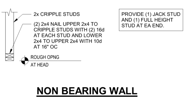

  • Use the “WALL GROUP” field to tag walls as “Non-load-bearing” to override all door and window headers to be 2 2x4s installed flat.

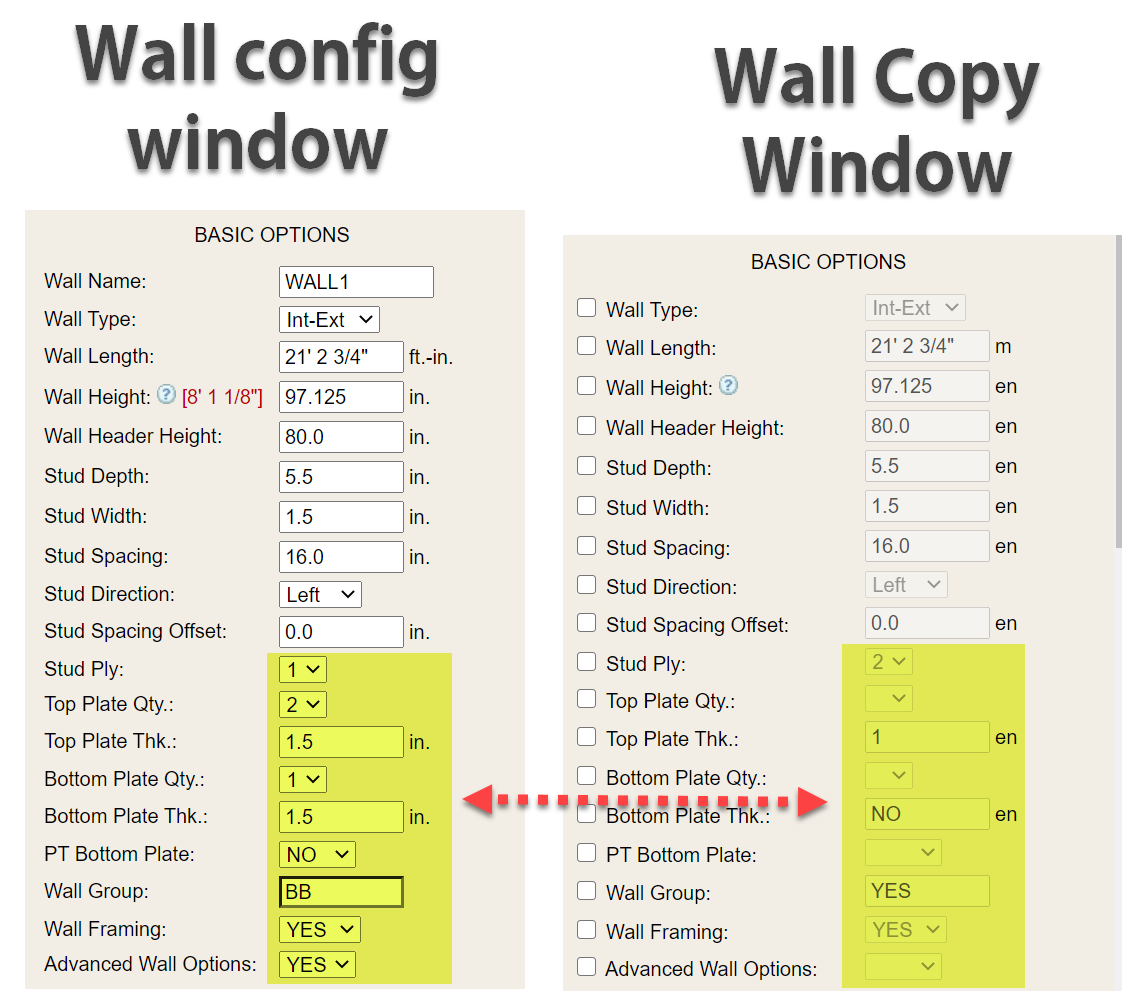

#Bug
There seems to be a mismatch with the parameters in the Wall copy tool window. Many of the parameters do not match the parameters of the wall that was sampled.
Yeah, that doesn’t look right. I’m looking at it right now.
Did you uninstall the plugin before installing the latest version?

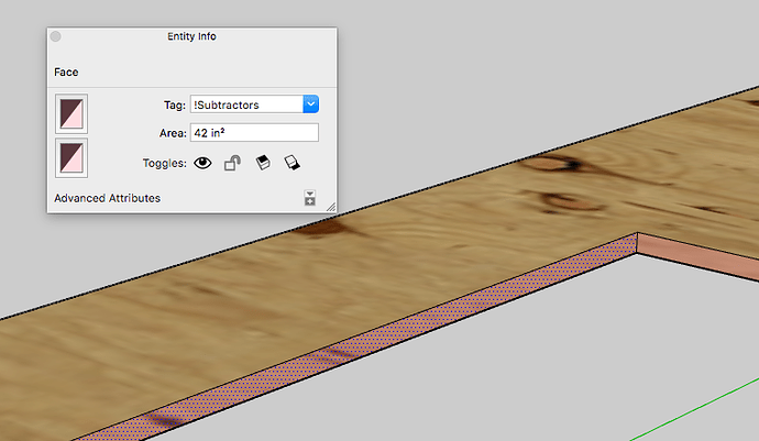

I just noticed a couple minor annoyances with the subtract function, and it’s probably the result of SketchUp’s own boolean operation anyway:
  1. If you paint individual faces, the geometry that’s produced by a subtraction takes on the texture of the cutting object, not the surrounding object surfaces. You can address this by using the “default” color for faces (both object and cutter), and paint the containers instead, and indeed your plugin paints sheathing as a container, not the individual faces.
  2. The raw geometry generated by the subtraction takes the Layer/Tag of the cutting object, not the cut object nor “Untagged.” That means if you hide the cutting object by turning off it’s Layer/Tag, the raw geometry that’s part of the remaining object also disappears leaving the object looking hollow even though solid tools reports it’s a solid. Putting raw geometry on a different Tag is contrary to SU’s official “best practices” proclamations, so it’s curious when their own tools create this.
Standing the 2" x 4" up on edge is a stronger header. They will deflect easier laying in this configuration. This is not a standard header configuration even for a non load bearing header.
I’m not getting this error with the wall copy tool. Can you send me a wall panel that is having this issue.
I completely agree with you. If I were building it, it’s how I would do it too. In this case, I’m not the designer so I’m just following what the structural engineer specified:
copywallbug.skp (730.3 KB)
I need to check if I’m running the latest version… Maybe that’s the issue…
That’s what I usually do when I update.
Where I come from that is standard for non-loadbearing interior door framing. If you turn them upright you need a 1/2 osb spacer. That is why they are turned flat. The double member is so there is wood there for fastening the casing.
