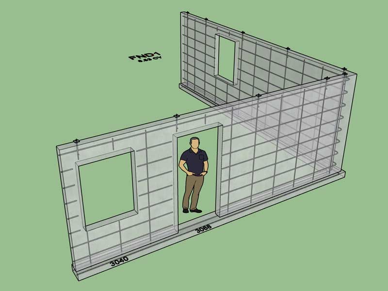

As nearly I can tell the convention for doors and windows in basement plans is the same as in regular framing, so here is my proposed solution for openings in foundation walls:
Note that the header height is measured from the top of the door or window opening with the RO taken into account.
So for example a standard 3068 door would have an actual opening width of 38" and an actual opening height of 82.5" (blockout dimemsions), assuming the rough opening dimensions given. Assuming that a 4" slab is poured on the top of the footing then the header height would need to be 84". The height of the top of the door opening measured from the top of the footing would be 80" + 4" + 2.5" = 86.5"
Correct me if any of this goes counter to common practice.
However, another way of dealing with the door may be to actually blockout the foundation all the way to the footing so that the 4" slab extends through the doorway (I’ve seen it done both ways). In this scenario you still want the door height (80") to remain the same so that the callout is still given as 3068, however to maintain the vertical position of the door within the foundation wall the vertical RO would need to change to 6.5" and the header height would need to be 80".
The seventh and hopefully final toolbar (at least for now):
foundation_opening_su_menu_active
This toolbar will allow the user to create, modify, move and delete openings (two types: doors, windows) within polyline stemwalls.
Once this toolset is added the plugin I think most of my major functionality issues with the plugin will be resolved.
The proposed parameters for Stemwall Openings (with default values):
Opening Type: Door (default), Window
Opening Width: 36"
Opening Height: 80"
Header Height: 84"
Horz. RO Offset: 1.0"
Vert. RO Offset: 2.5"
I would advise at least considering the “Brickmould” size for these openings.
In the case of a Thermatru 3-0 pre hung unit that would be 40 1/8" by 79 9/16"
Given the quality of workmanship I’ve seen in some these poured walls, I’d probably shoot for a half inch or so over this dimension.
This is of course for insetting the unit in the wall.
Just a thought.
Shep
How about for windows? What would be a good/safe default RO offset?
So many windows so little time. I guess maybe 2" all around over unit dimension, in a case where the window has a flange all the way around.
I think the designer has to be responsible for sorting out how the unit is set and trimmed.
There may be a terminology issue here too. To me at least, a rough opening is an inch or so more than unit dimension. The opening in a foundation would be more of a finished opening.
So, for example if you have a 36" unit requiring a 37" R.O. and you have a 2x6 p.t. frame lining the foundation opening. That opening would be 40".
I hope that makes sense.?. So you are saying the 1.5" is the offset?
The way I am setting this up the designer will be able to customize their offsets as required so regardless of the default value one can always make adjustments.
However, I’m just trying to converge upon a reasonable/typical value for these offsets. A door type opening will utilize a horizontal and vertical offset which may differ, however the window type opening will only use one offset (for vertical and horizontal).

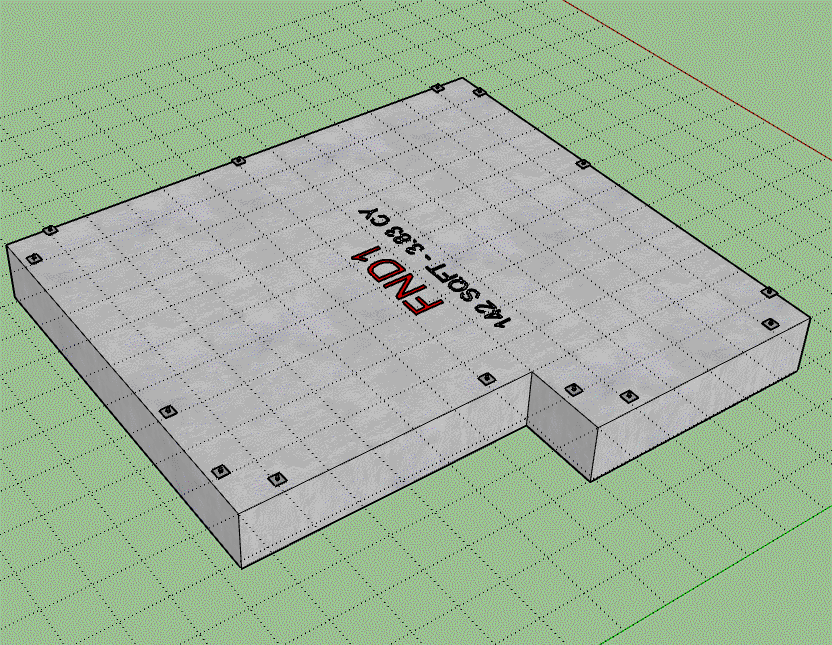

Adjusting a Slab on Grade foundation with brick ledges:
