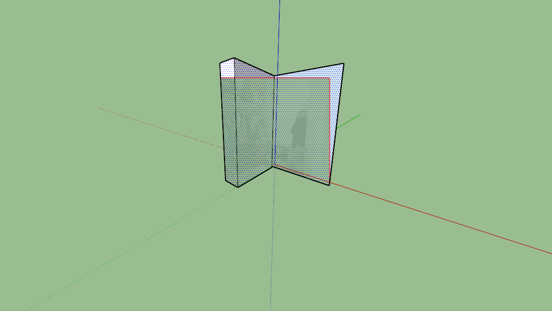

I’d like to model on top of an existing photo, to show customer an overlay of some cabinetry…
Is there a way to have my model look with uniform opacity both on the photo and off?
Note that in my screenshot, the opacity changes drastically as the image overlaps the photo…
Thanks!
I’m not sure what I’m looking at or what’s going on. It doesn’t look like you are currently in a Match Photo Scene there.
In the Styles tray, Edit, Modeling Settings (the last of the edit icons) you can choose whether there is a foreground or background photo, and their transparencies. Just turning off foreground photo may be enough to get what you want.
Thanks!
How do I get the original (matched) photo back once I navigate to a different perspective?
Scene tab
Dave beat me to it. It’s a scene. There should be scene buttons along the top of the window. BTW, the scene button restores the “photo fills the screen” view even while editing your Match Photo set up.
