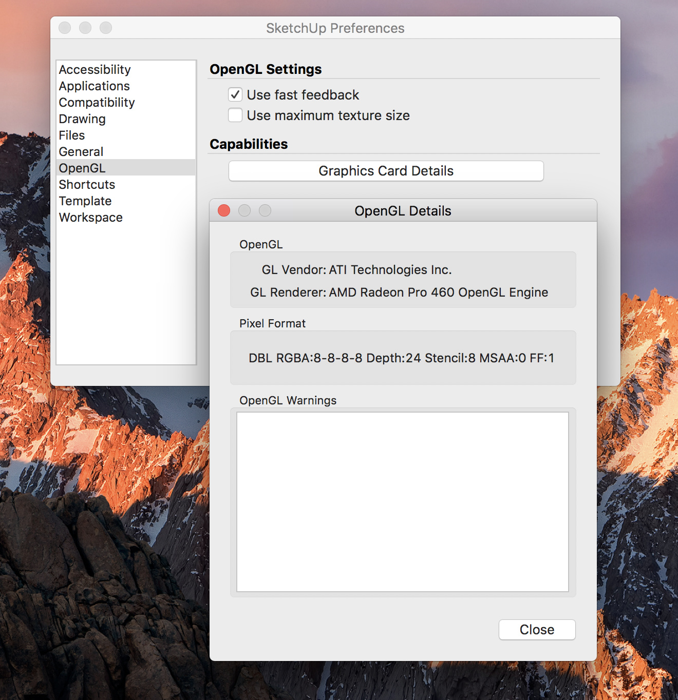

If I delete the installation folder and the sketchup and Trimble plist files, I can re-installed SketchUp and get to the Preference pane and see the video card attributes (Radeon Pro 460)

I tried using the Intel graphics and the discrete Radeon gpu, but no difference.
