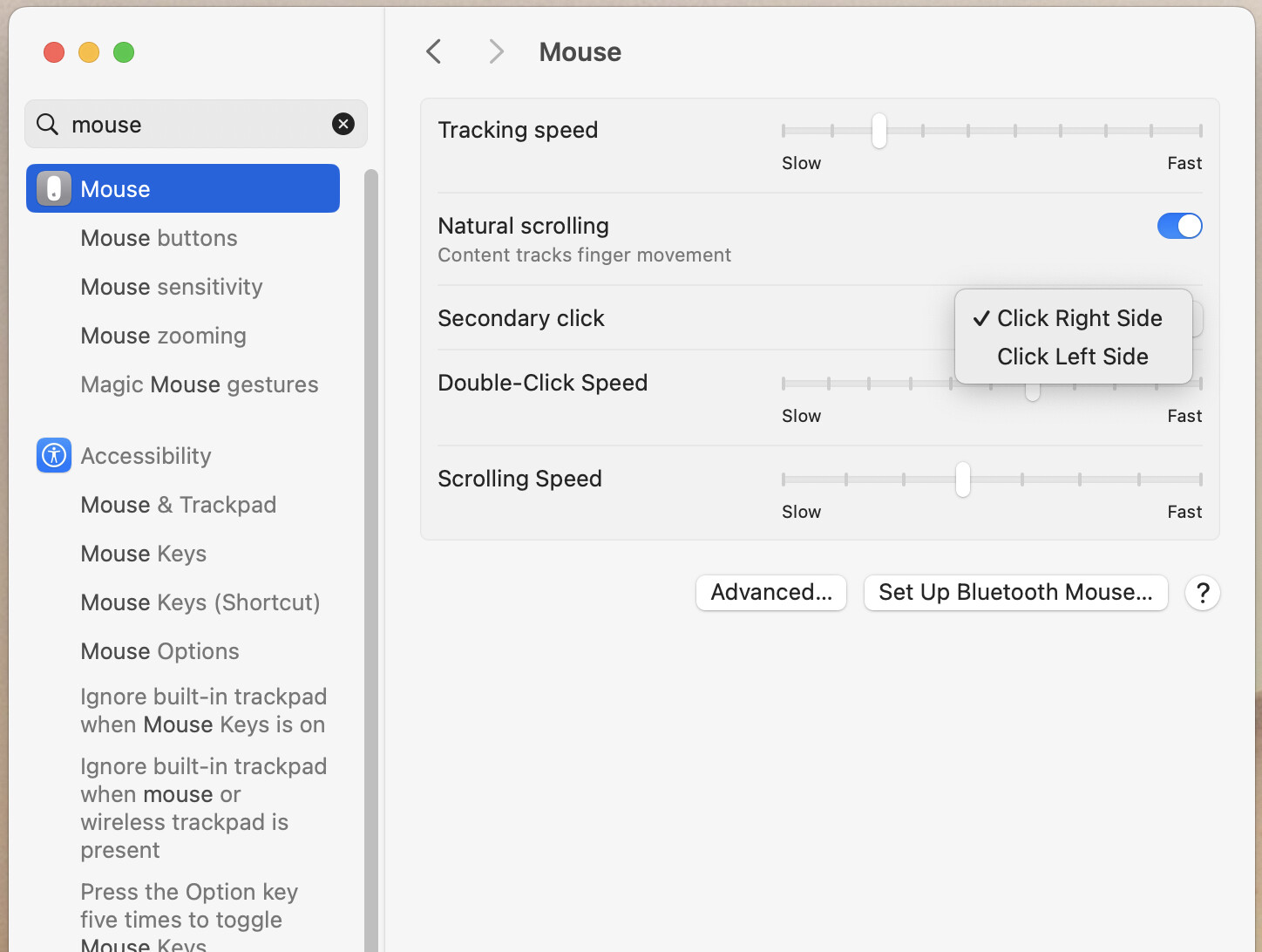

In the Mac System Settings > Mouse Settings, there is no middle mouse settings…

Yeah, macos removed that parameter some time ago, now it should work as a mid click by default (you can only swap right and left), and it delegates the buttons mapping to the specific apps you have to install.

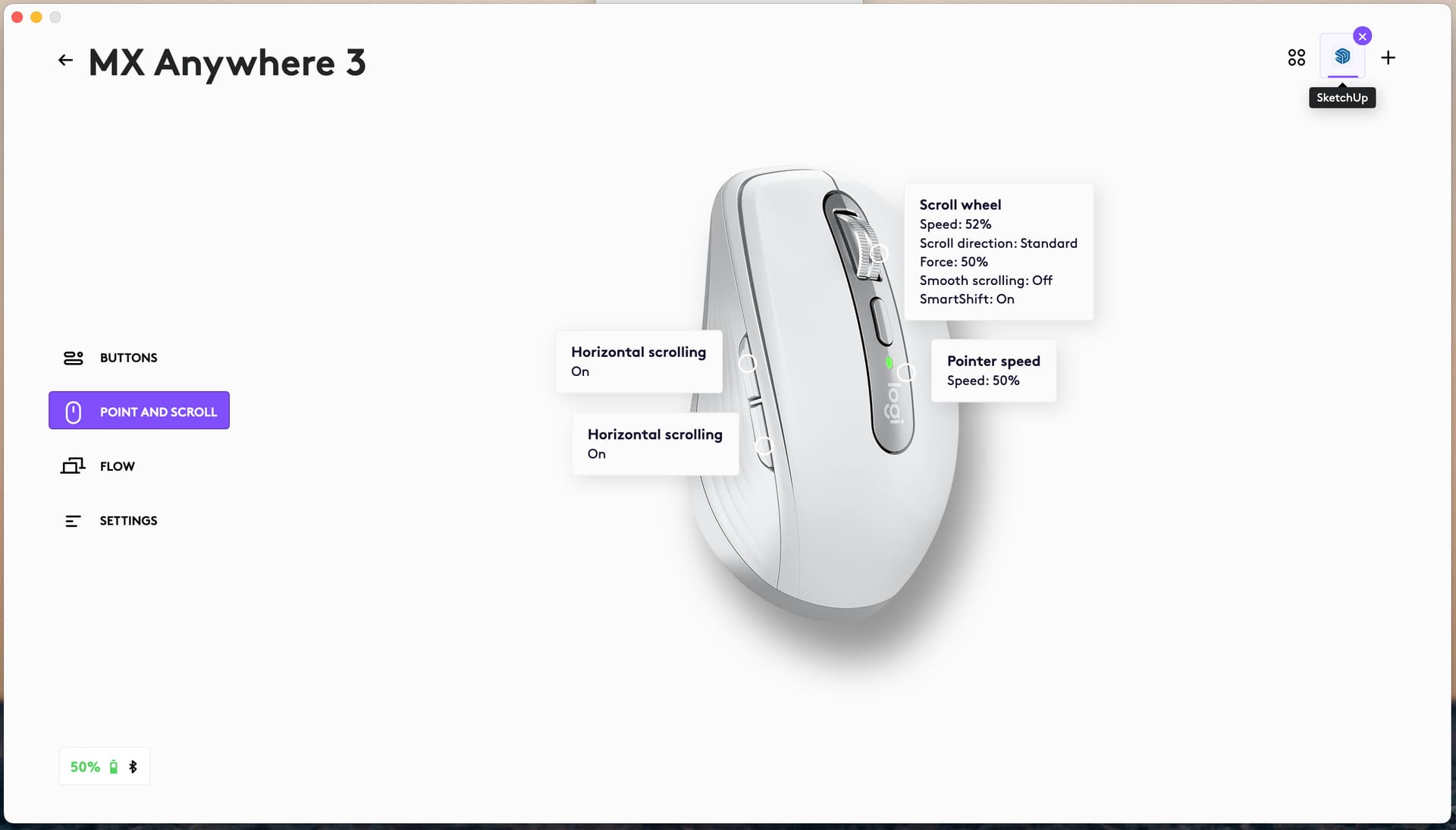

In your last image, in LogiOptions, you’re looking at point and scroll. But right above (left side) in Buttons, you should be able to give the wheel the mid click.
2 things to try if it’s not working :
  • don’t set up a sketchup mode. or turn it off. I’m using a mx master 2, no mode specific to any application, just try with a global parameter. I’ve seen issues with that in a few games
  • just below your wheel there is a button. by default it changes de dpi, try to give it middle click instead and test. If it works, then your wheel has some issues.
here is my setup, no app specific setup, and middle button mapped to both the wheel click and the central button (I find it more confortable, it’s an actual button, it won’t scroll)
