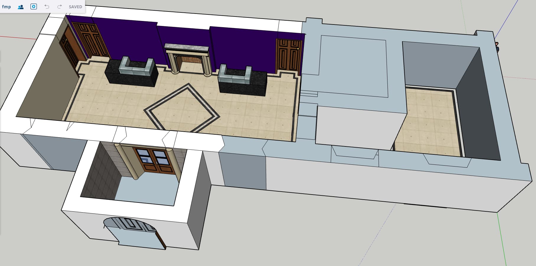

Something is up, I watched with my own eyes her open up a project she completed last year, she saved it then closed it when we opened it up seconds later it looked completely different as if most of the information was missing.

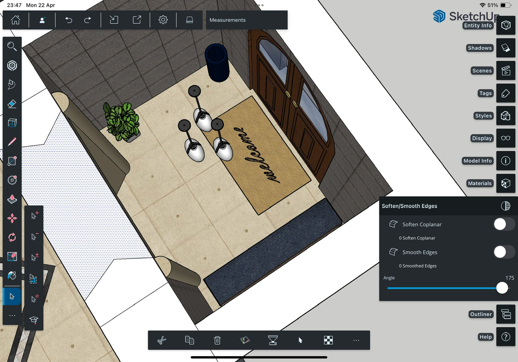

SketchUp for iPad has the ability to save locally to the iPad, or to Trimble Connect. I would check to see if that is the issue. For the file saved on Trimble Connect - you can see the versions and when the model was published to Trimble Connect.
I see that the file is shared via SketchUp for Web. When a file is shared then SketchUp may perform a save in the background in order to keep the shared link up-to-date.
This is my hypothesis:
Your daughter has a week-old copy of the model open in SketchUp for Web in a tab on a computer somewhere.
Some form of autosave has caused that old file to be uploaded to Trimble Connect.
When she opens the model from the iPad, that “lastest” version is opened, which is actually the one recently saved from a stale browser tab.
Regardless of what caused this problem, the resolution is probably the same. Open the revision history and find the one you want. You can open the model revision history from SketchUp for Web or Trimble Connect. In SketchUp for Web you can restore the revision and it should appear again on SketchUp for iPad.
I think @paul_hudlow is on to something… the first two images show SU for iPad… the third one (what it looks like now) looks like it is open in the web app… I would guess that a more recent version may still be on the iPad, saved locally?
