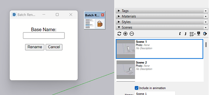

This was 50% successful, except clicking on “Rename” did not do anything at all. ChatGPT edited the script several times, trying to get it to work but sadly unsuccessfully. I was too tired at this point, so I just closed everything. :face_with_hand_over_mouth:

Anyway, - without further discussing AI - here it’s half-baked code, more or less working, but nowhere near finished and ugly. Use it or leave it… as you like! Copy-paste it to Ruby Console to try.
. :beer: . :peace_symbol:
JFD: Dezmo, can you do a, b, c and x, y, z?
Dezmo: Hold my beer.
I’m only a little disappointed that your donate icon isn’t included ;^)!
On Su '23:
Because the topic opener said he can do it… anyway - is is a just snippet - you need to create a proper Extension structure… and include the icon in the extension folder, beside this .rb file.

@ViggoPaulman I went ahead and created a registration file and a loader file using your code in “main.rb”. The gist of your extension looks like this (with the exception of the added Dezmo icon):
I believe that Dezmo may be correct that selecting active scenes (as in the Scenes in the Scenes panel/tray) will not work. I don’t use Mac so I’m guessing the Scene Manager in Curic’s video is also an extension and not the Mac version of the Scenes panel/tray.
Anyway, you can see that they are getting the scenes in the model, displaying them, and selecting from them. That may have been a point where you went off course a bit.
You have some working examples now. But I’m going to see if I can fix your version as well. “Practice makes perfect” they say (and let’s hope ‘they’ are right).
Here is your version with the adjustments for making an extension out of it:
BatechRenameScenes.rb registration file:

Still messy,
main.rb
module IDK_Programming
  module BatchRenameScenes
        def self.rename_scenes(base_name)
            model = Sketchup.active_model
            selected_scenes = model.pages.selected
            return unless selected_scenes.any?
            active_scene_index = model.pages.active_page.index if model.pages.active_page
            selected_scenes.each_with_index do |scene, index|
                new_scene_name = "#{base_name} #{index + 1}"
                scene.name = new_scene_name
            end
            model.pages[active_scene_index].make_current if active_scene_index
            end
            def self.show_dialog
            dialog = UI::HtmlDialog.new(
                title: "Batch Rename Scenes",
                style: UI::HtmlDialog::STYLE_DIALOG
            # Set the HTML content for the dialog
            dialog.set_html(<<-HTML)
                <html>
                <head>
                    <title>Batch Rename Scenes</title>
                    <style>
                    body {
                        font-family: sans-serif;
                    </style>
                </head>
                <body>
                    <div style="padding: 20px; text-align: center;">
                    <label for="newName">Base Name:</label>
                    <br>
                    <input type="text" id="newName" style="width: 80%;">
                    <br><br>
                    <button onclick="renameScenes()">Rename</button>
                    <button onclick="closeDialog()">Cancel</button>
                    </div>
                    <script>
                    function renameScenes() {
                        var baseName = document.getElementById('newName').value;
                        sketchupAPI.renameScenes(baseName);
                        sketchupAPI.closeDialog();
                    function closeDialog() {
                    </script>
                </body>
                </html>
            HTML
            # Set the position of the dialog to the center of the screen
            dialog.center
            dialog.add_action_callback("renameScenes") do |dlg, base_name|
            end
            dialog.add_action_callback("closeDialog") do |dlg, _params|
                dlg.close
            end
            dialog.show
            end
            toolbar = UI::Toolbar.new("Batch Rename Scenes")
            # Existing command for Batch Rename Scenes
            rename_cmd = UI::Command.new("Batch Rename Scenes") { BatchRenameScenes.show_dialog }
            icon_path = File.join(File.dirname(__FILE__), 'icons', 'BatchRenameScenes.png')
            rename_cmd.small_icon = icon_path
            rename_cmd.large_icon = icon_path
            rename_cmd.tooltip = "Batch Rename Scenes"
            toolbar = toolbar.add_item(rename_cmd)
            # New command for Beer button - add link.
            beer_cmd = UI::Command.new("Beer") {
            UI.messagebox("Cheers with Beer!")
            beer_icon_path = File.join(File.dirname(__FILE__), 'icons', 'beer.png')
            beer_cmd.small_icon = beer_icon_path
            beer_cmd.large_icon = beer_icon_path
            beer_cmd.tooltip = "Beer"
            toolbar = toolbar.add_item(beer_cmd)
            toolbar.show
            UI.menu("Extensions").add_item("Batch Rename Scenes") { BatchRenameScenes.show_dialog }
    end
end
