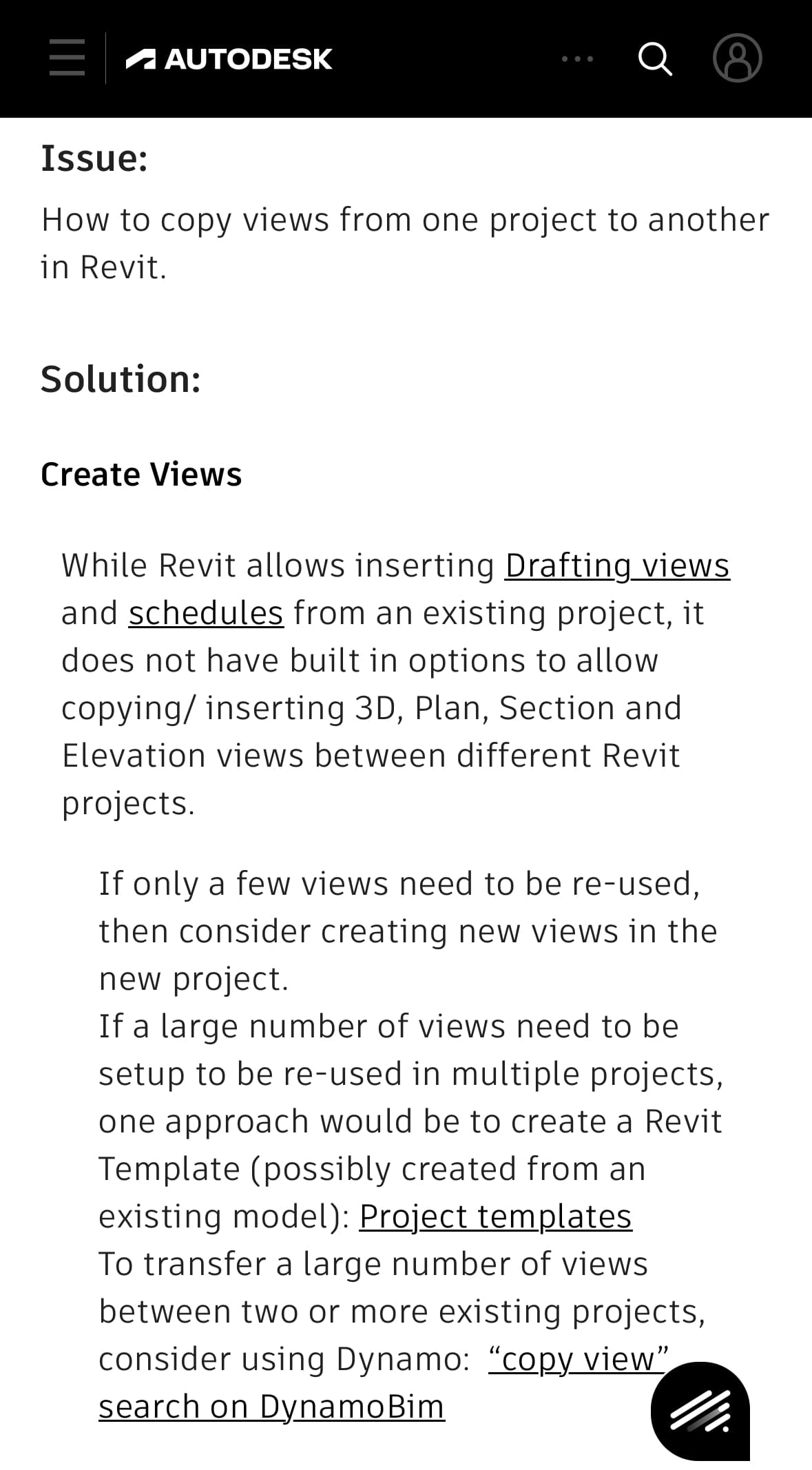

Dang… I wonder why Revit, Rhino, Lumion, Enscape, 3dsMax, Solidworks, Blender, Maya, Vectorworks, ArchiCAD, and Formit all have this ability when users just don’t have a need for it… :man_shrugging:
If any other users find this post, just know the only workaround is to A: buy a $20 plugin or B: recreate the view or C: copy and paste the entire file’s geometry to the file with the view you want. Sketchup will never have the ability to transfer/copy a scene to another file because it’s easier to just recreate the file or the view.

do they though ?
fun fact, sketchup cost + a one time 20$ is still lot cheaper than the aforementioned softwares.
also, the free plugin Francis found.
I don’t have time to check the rest of the software you listed.
