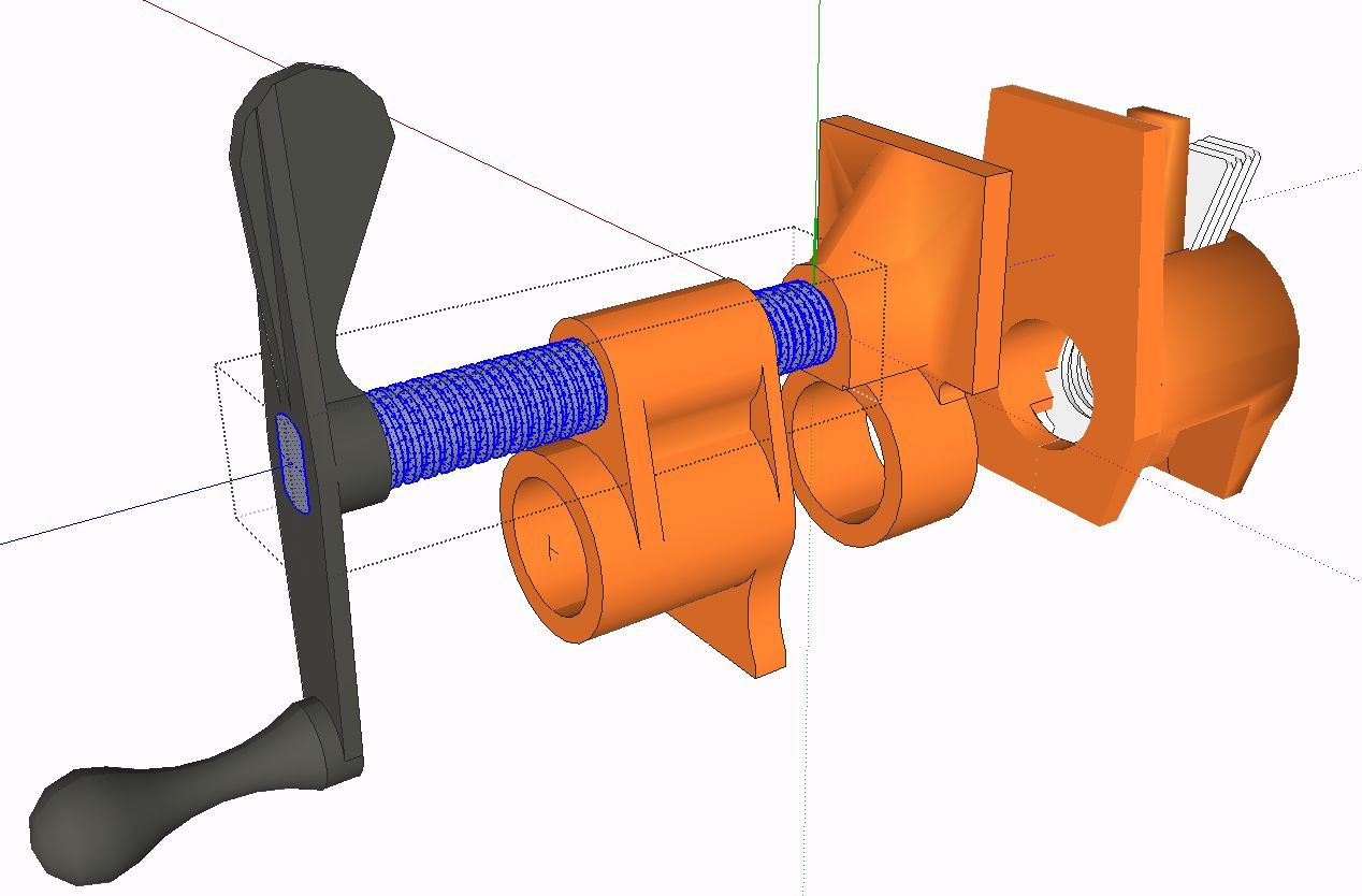

Using components, especially when you have repeated entities can be a big help. For example, the model for this pipe clamp has elements split into smaller components. For example, the threads on the screw are divided into small sections as shown by the highlighting. The cast parts of the clamp are divided in half–I drew half of the part, made that a component, copied and flipped to make the opposite side. The file size is 138Kb

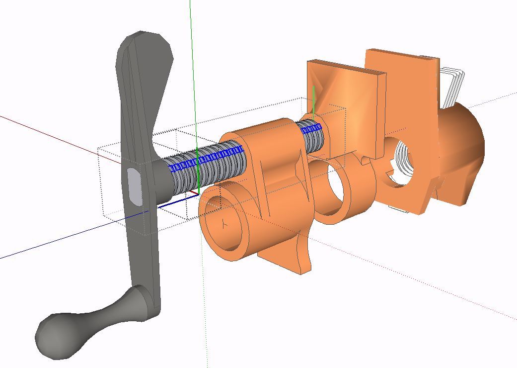

On the other hand, after exploding the screw into a single lump of geometry and doing the same for each of the cast parts (jaws and crank), the file size ballooned to 938Kb.
