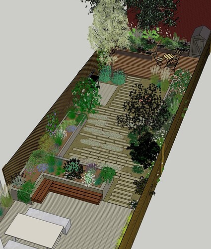

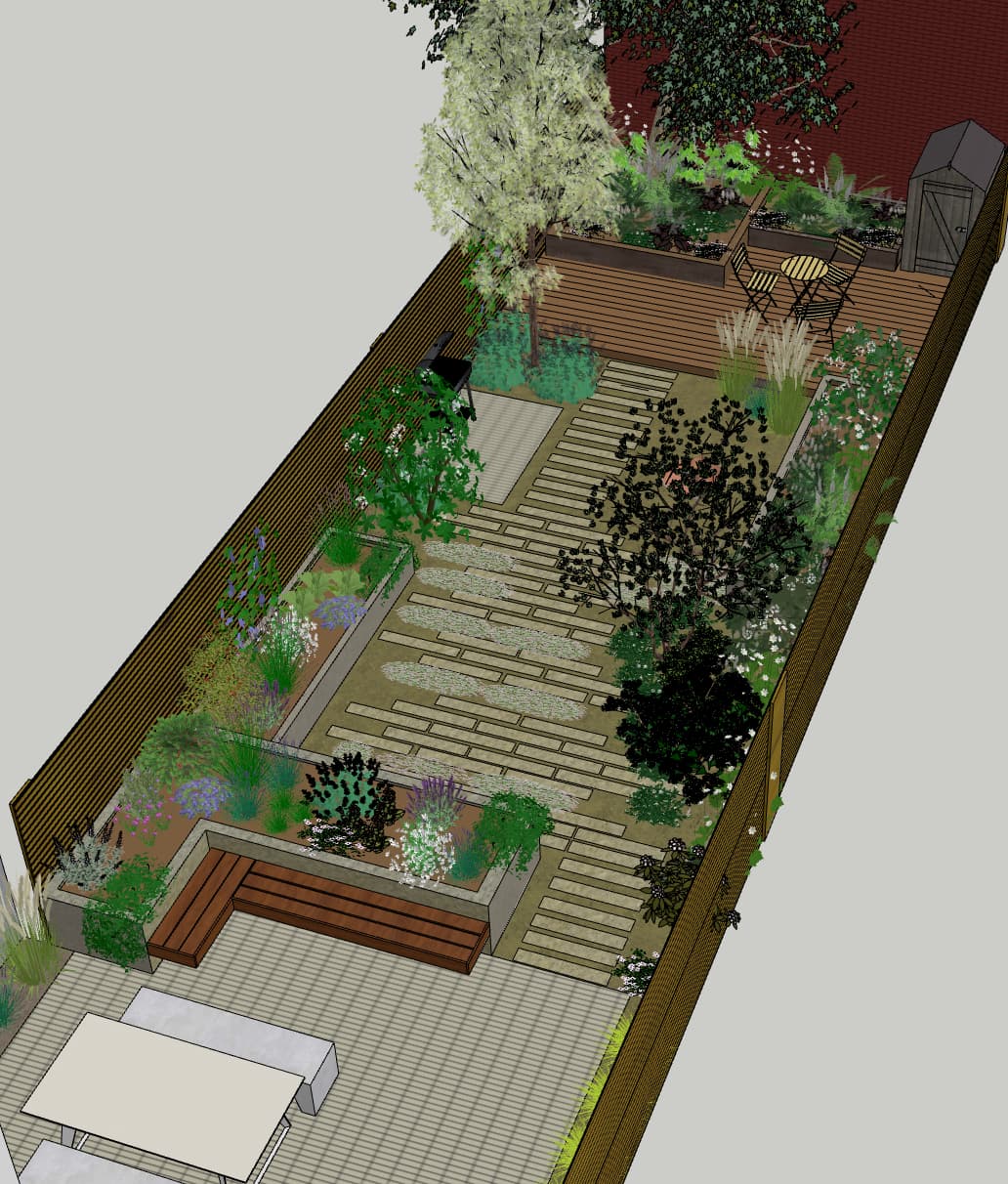

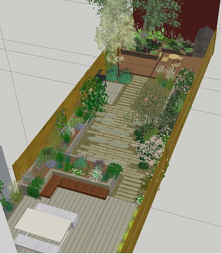

These are the screenshots with edges on and off. Im not exactly sure what you mean, I “edit component” on the plants ?
Here’s an example from 3D Warehouse, where the author took the time to make each leaf be smooth and softened, with hidden edges. The one on the right is as it comes from 3DW, the one on the left is what it would look like without the softening and hiding.
To hide the edges you would tunnel down into a single leaf, select all, right-click Select/Deselect Faces, then Edit/Hide. All places that leaf is used would then have hidden edges.
