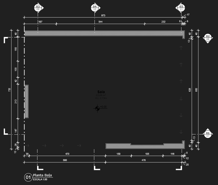

Hi, everyone! Been having problems with blank viewports on LayOut. I’ve read some topics and i’m not quite sure if it’s my problem. If it is, maybe I can at least provide more details about the problems since apparently there’s no solution as of now.
All of a sudden, viewports go blank. Styles show question marks. In one particular project, two floor plans remained even if all the other viewports went blank, i’ll try to send a video.
I noticed it seems to be a raster style problem. Switching to vector bring my viewport content back, but it is not viable to me since my viewports are a bit too complex in geometry.

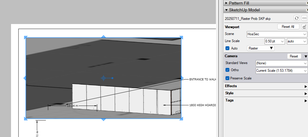

Attaching two screenshots of the error with my actual file. I’m using black pages for a special presentation.
I won’t attach files since it occured on all of my last projects since a lit before the last patch, so it is not a file problem.

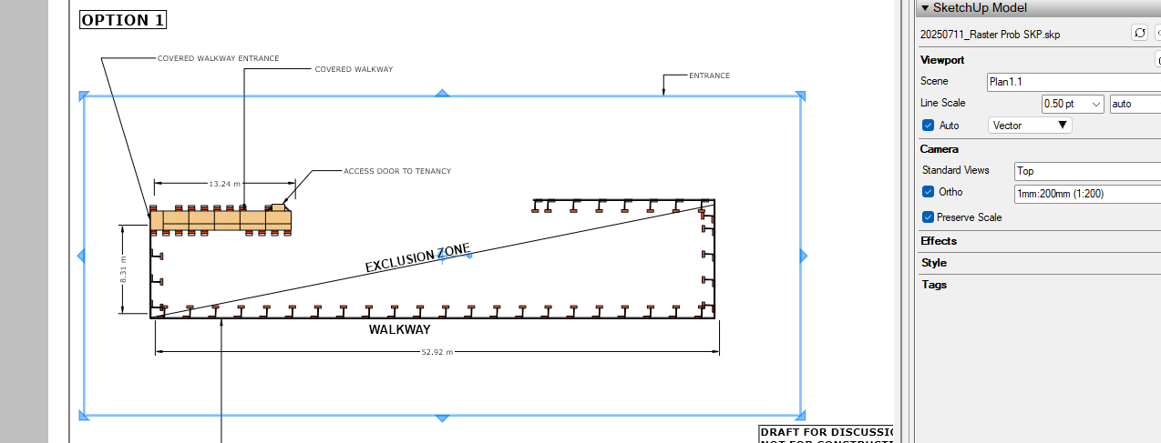

When I opened your file this is what I saw with the viewport rendered as Raster.
The background image and textures shouldn’t be displayed if the viewport is rendered as Vector but they will if rendered as Hybrid.

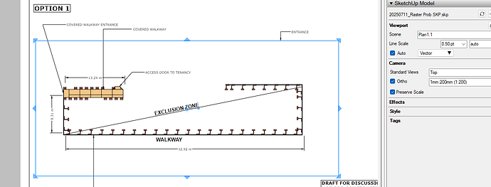

Vector rendering:

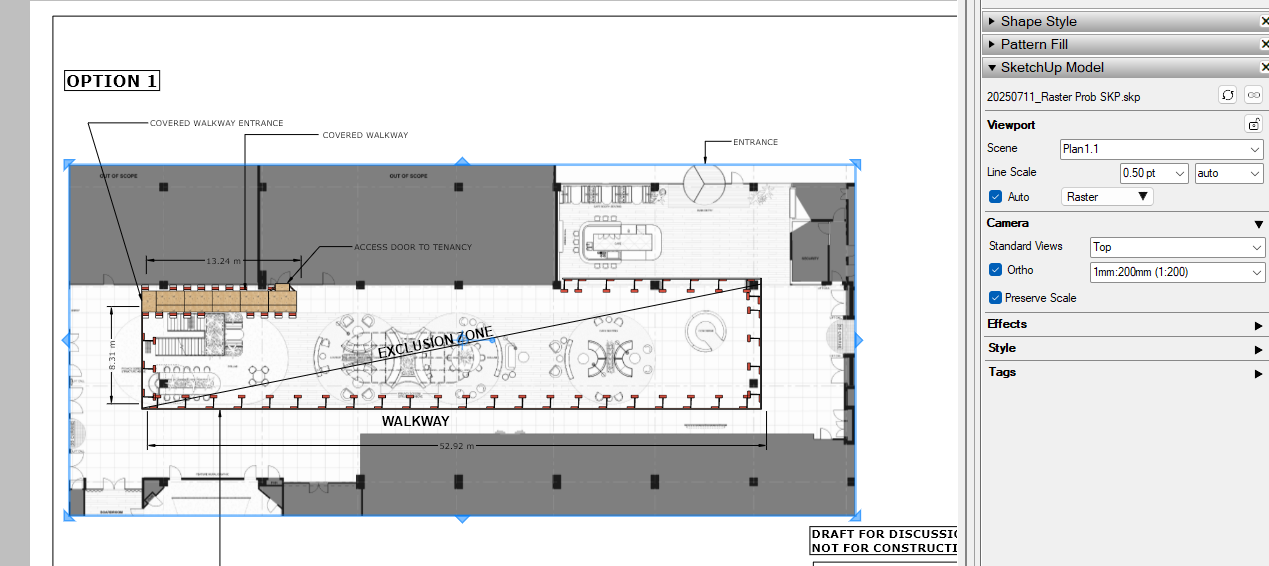

Hybrid rendering:

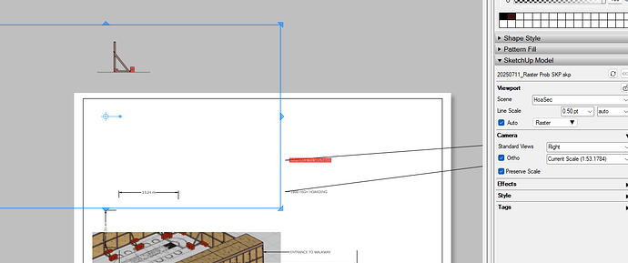

The only viewport that goes blank for me is the top one on the last page and only when the Camera is reset but that’s due to how you set up the viewport. Enlarging the viewport enough reveals the model as it is suppose to look in the selected scene.

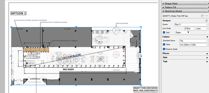

After resetting and enlarging the viewport.
