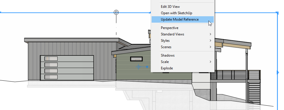

Try unlocking the VP layer and then right click on the a viewport. Choose Update Model Reference. Doing that here got rid of the shadows.
