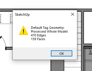

Yeah. I’m not seeing any problems in the file you uploaded.
I did note a little incorrect tag usage–possibly from 3D Warehouse components–and a bunch of unused stuff in your model.
Johnson Cabin Concepts purged.layout (3.5 MB)
