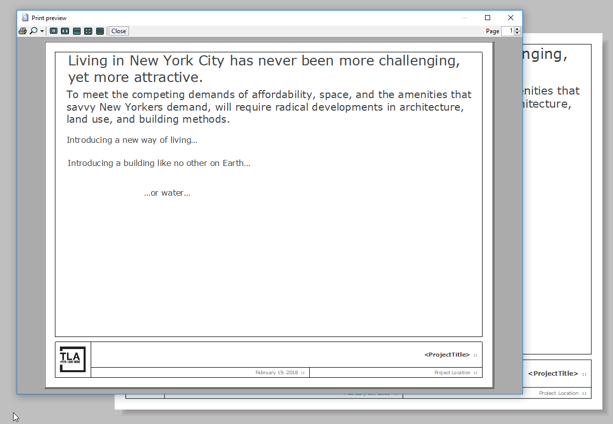

Print Preview on my computer shows this:
And the PDF: Cover page only.pdf (27.9 KB)

My print preview looks nothing like that. Is it a driver issue with my HP laserjet 200?

This is what my preview, and final print, looks like. As you can see, it truncates the page:
