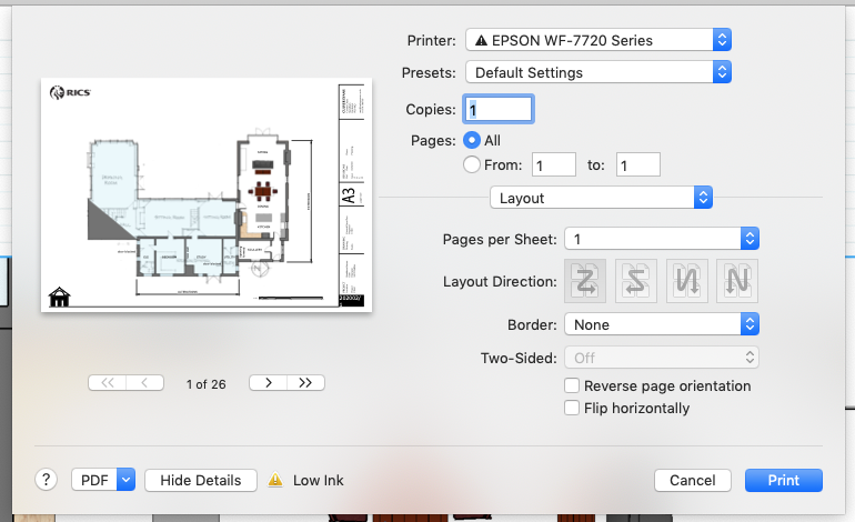

Your setup and mine are broadly similar but you are experiencing an issue I don’t. Unlike you, I only have one printer and that is set as my default. So when I go to print from LO, I get a dialog box like this:
If I want to print to paper I use the blue highlighted print button. If I want a PDF, I use the button at bottom left. I don’t normally have to change anything so there is no re-rendering that I am aware of. I guess if you were changing from the default printer it might take a moment or two to reconfigure.
What I do sometimes get is the wrong paper size. Even though almost everything I output is at A3, the preview image sometimes selects an A4 sized portion. I don’t know why but cancelling the print and doing it again usually cures it - a nuisance, and probably a bug, but not a biggy.
