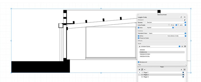

On page 2 of the attached file, the top scene is meant to be a section I set up in SU. To create it in LO, I copied the window below it and then changed the SU scene and Standard View (to None).
LO will allow me to change to Section but will not allow me to change the standard view. Which means I get the odd thing you see here:

You altered something within LO, so you need to ‘Reset All’ in order to get the scene to update.
Simon, we’ve been over this several times, you and I. Modifying the Camera properties for the scene in LayOut will prevent the camera position changing when you change to a new scene. Every viewport in your LO file has the Camera properties overridden. You should reset them all before you do anything else. If they aren’t correct for what you want to show in LayOut, go back to the SketchUp model and fix the scenes or create appropriate ones.
