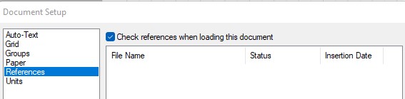

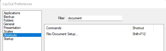

I have a shortcut key assigned for that. Well, it almost takes you there. It opens the ‘Document Setup’.
LO doc setup
Luckily it remembers the last viewed task:
LO2

I also have a shortcut and if you type A immediately after the Document Setup dialog appears, you have the Auto-Text window open, G toggles between Grid and Group, P for Paper, R for References and U for Units.
