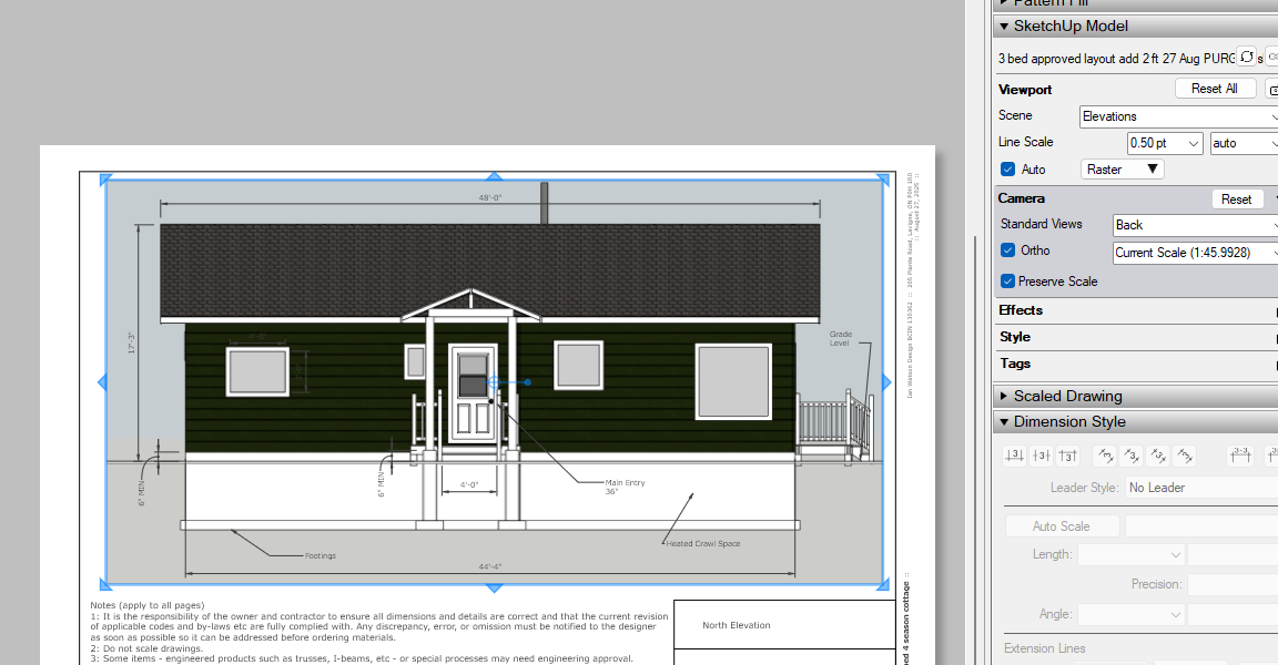

In your LO file I note that your front elevation shows you’ve modified the Camera properties for a different scene. Doing that can create issues for you. I reset the Camera in LO and changed it to the “Porch” scene to show the front elevation.

I noticed you are using the same scene for all of your elevations and modifying the Camera properties in LO. This is risky and can create a mess. Case in point:
It would be better and result in a more predictable LO file if you create an elevation scene for each required elevation in SketchUp and avoid modifying the Camera in LO.

Now I didn’t know that using a scene for all elevations was bad – I had thought it was efficient to keep the number of scenes down in SU. SO there’s something I will change.

It is generally easier to manage your model if you keep the number of scenes down but it clearly wouldn’t be efficient to have to fix the dimensions and labels in your LO file if the viewport accidentally gets reset after you’ve modified the Camera by selecting different standard views in LayOut. Easier to just make the required scenes for the elevations and remove the chance you’ll have to redo the dimensions and labels in LO.
