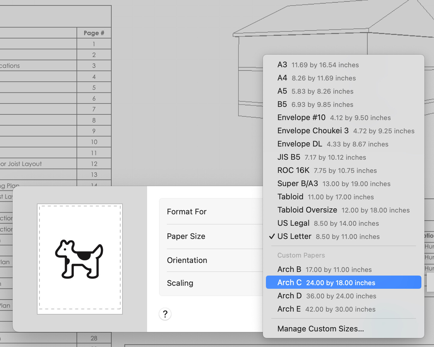

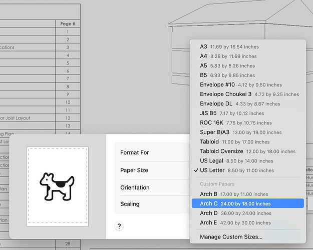

I do not have a printer attached to this computer. I added a custom page size 18x24 to the page size list
I have to select this every time before I try printing to a pdf in the print dialogue box.

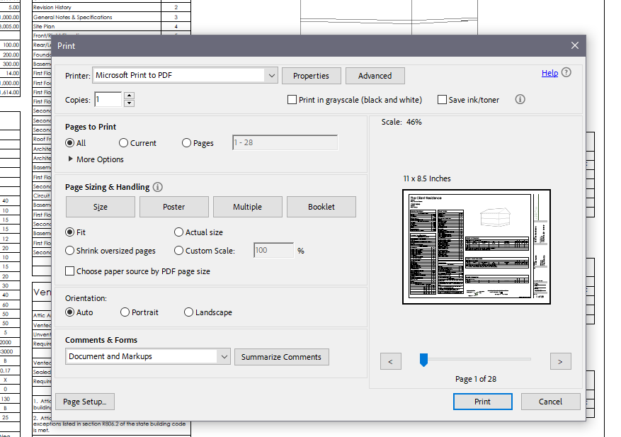

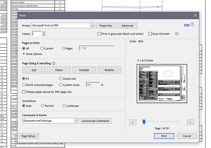

Exporting to PDF should export the paper size you selected in Document Setup>Paper no matter what size paper you have set. Here’s the print dialog from Adobe reader with the PDF I exported from your You can see the size of the page. The light rectangle shows the print area because the default for Microsoft Print to PDF is 11x8.5 inches. that 11x8.5 in. is coming from the system, not LayOut.

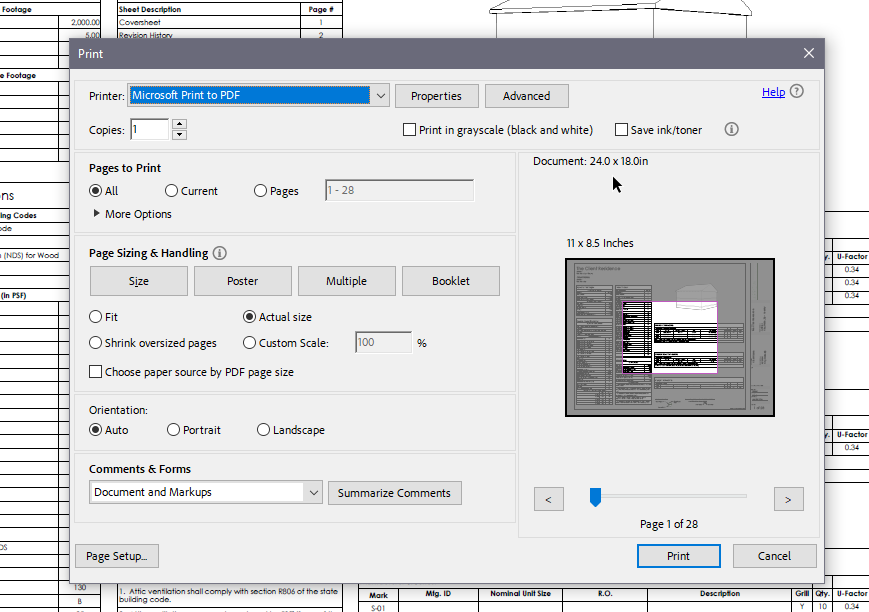

The uploaded one opens in Adobe Reader on my end as 11x8.5 in. It also shows that it had been scaled from the original file in LO. I wouldn’t call that coming out correct.
