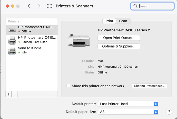

When I select page setup, select the printer and OK the document reverts to A4, as you point out controlled by the paper size of the printer.The same results also apply when I select any printer. Returning to Document Setup/paper I can reset the page size and it again looks correct.

Selecting Page setup/ then PFormat for/ Printers and scanners
I selected the printer page to be A3 (landscape)
On its own this did nothing
I had to Reselect Page setup and the Page Size : A3 (it was still defaulting to A4)
This gives the right result when I select Print/ PDF/ open in preview
however it still reverts to a cropped image if I export it.
If I select Print/ PDF/ Save as PDF it exports the PDF correctly
