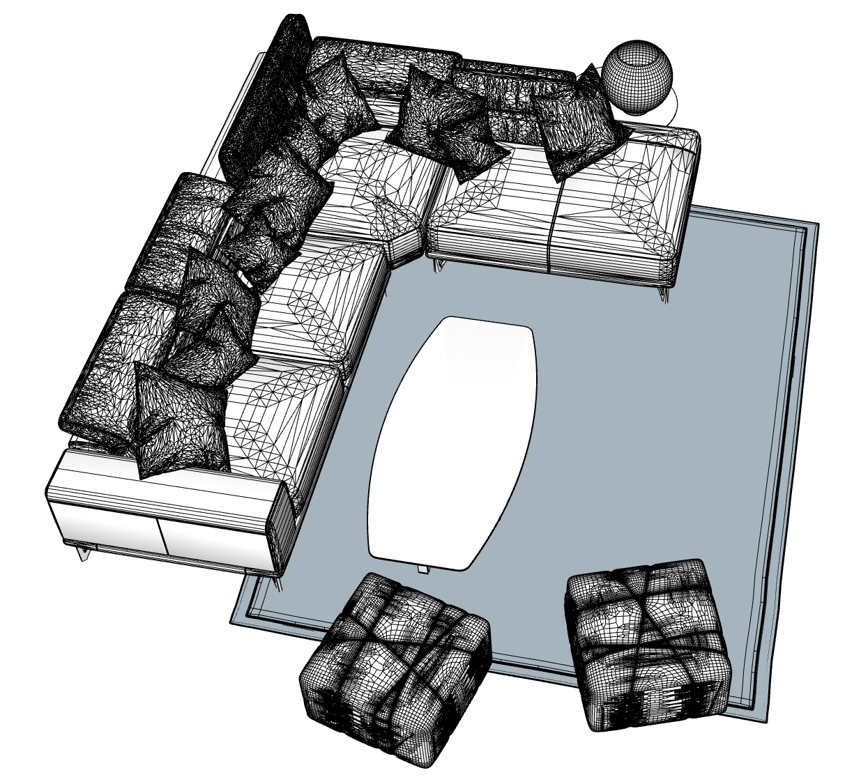

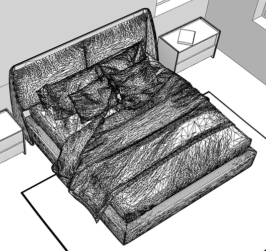

You need to replace the heavy components like the beds …
… couch and ottomans …

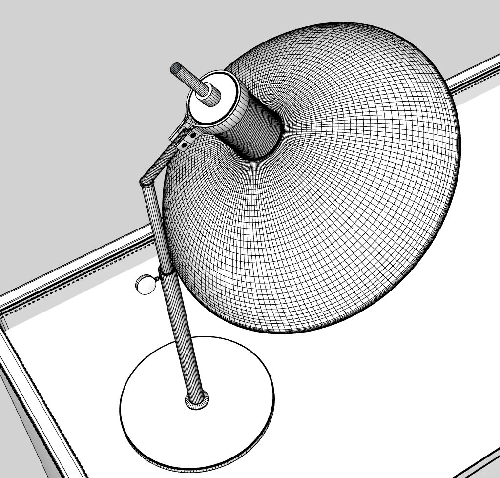

… and even components like the lamp in the bed room …
… with much simpler lower-poly components with smaller texture files.
