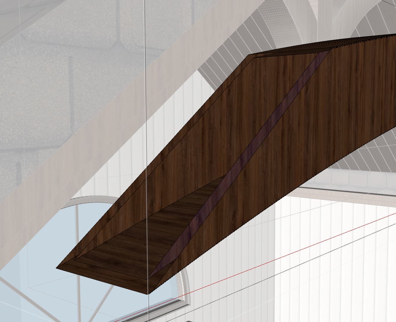

By the way, there’s a very useful plugin called Zorro, which lets you slice objects as if with a knife, and also adds an extra function to the Section Planes - “Slice Model At Section”, which uses the Section Plane AS a knife.
Let’s say I need to cut this decorative beam to the angle of the roof.
Slice Model At Section - done. The beam is cut to the roof line.
VERY useful and saves a lot of time and frustration. Then you just delete the section plane and move on with life.
Couple of things to note:
1.) Make sure the section plane is in the context (group or component) of whatever you’re slicing, otherwise it will cut through the whole model.
2.) The cut edge is going to be empty (no face):
