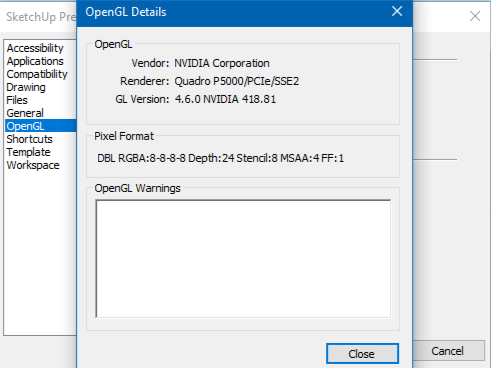

This gives me the impression that SketchUp has not recognized the GPU - can you confirm?
All GREEN in my SU2019CheckUp, is there another way I need to check and ensure that I am correctly connected to the GPU?
In the SketchUp app -
Screenshot%20(4)

Just ran an update for my drivers and now my SU2019CheckUp is saying as fallows, Warning: We were unable to determine the graphics memory available. SketchUp requires 256MB of graphics memory to run.

SketchUp user with P5000 - disabled Intel gpu in the bios which seemed to fix the problem, I think.
