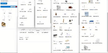

I don’t think an extension is necessary since there are at least three native ways of doing this, the simplest being to have (multiple) windows explorers open with the view set to thumbnails::
windowsexpolorerdraganddrop
