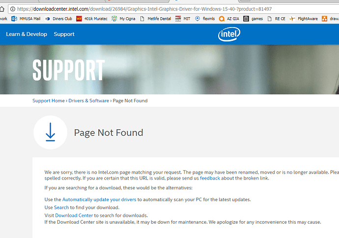

Is it possible to be more specific? I have tried Intel site. I tried using Lenovo site. Getting the blank template screen for half a second is the closest I got with the latest Lenovo updates.
Since updating the driver wasn’t effective, the next thing to do is update the card. Unfortunately for many notebook computers, that means replacing the entire computer.

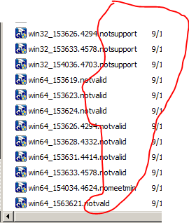

So far, none of the Intel 4400 drivers on the Intel site work for my laptop either because it’s “not validated”, “not support”, or “not meet minimum…”. I even tried 32-bit versions just for kicks.

Evidently not. Your problems stem from your graphics drivers. If there isn’t a suitable driver for the card, then your computer does not meet the requirements.
