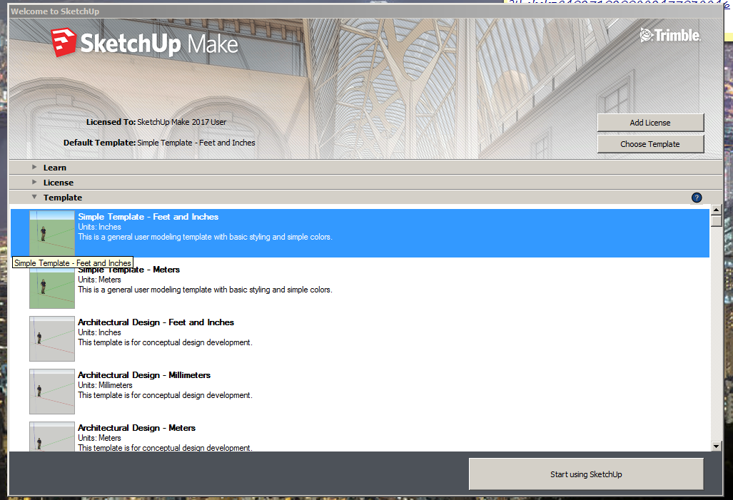

Hi, everyone.
I’ve been trying to get SketchUp Maker to start up on my laptop but the program keeps crashing.
SketchUp 2017 Checkup says I pass.
I can only make it to the prompt window screen.

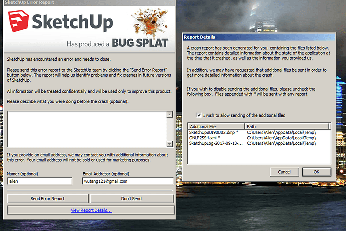

When I click on “Start…” (SketchUpMake-en-x64), the system crashes and I end up in bugsplat window.
I’ve tried Windows Update, Lenovo drivers update, Intel Graphics check update, uninstall/reinstall SketchUp, and delete/install some of the C++ Runtime libraries. Nothing seems to work.
I’m at a total lost. Can someone hold my hand and figure this out?
Thanks in advance.
The first question to you is, did you install SketchUp correctly? That is, did you right click on the installer file and choose Run as administrator?
I looked up the crash. It looks like your Intel(R) HD Graphics 4400 is causing the crash. You will need to update the driver through Intel to get that up and running. Some Windows updates will revert your video card driver so you may need to re-update them.
I think I did. I am the only account holder of the laptop. I also performed your suggestion with the same results.
