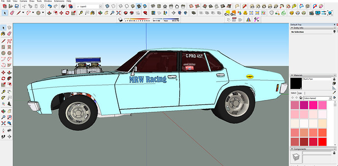

When I tried it, on the wrapped surface of my oil filter, it worked as far as pasting it in place, only that the background of the rectangle was blank, as in clear.
filter.skp (1.5 MB)
filtrec
Since the pixels surrounding the text is transparent, of course the surface you are applying the texture to is going to show that parts as transparent. If you don’t want the surface to be transparent you need to make the pixels surrounding the text opaque.
Sorry I’ve taken so long to reply Dave. I haven’t been well of late. So, I think my age is catching up with me, or that I’m just completely dense. If I’m trying to place an image on a coloured surface, how do I make that image (png) opaque? This is what I’ve been trying to achieve without any luck so far.
