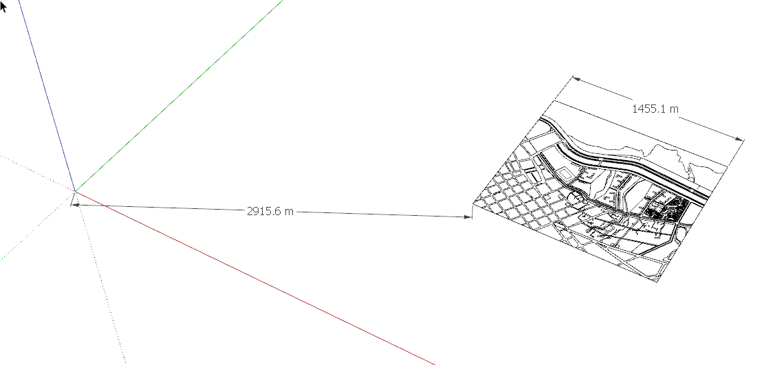

When I import the .dwg file using these options, I get this. Note that I’ve added dimensions. You wouldn’t see anything in SketchUp if the camera is zoomed in on the origin.
Untick the box in the middle for Preserve drawing origin and the .dwg will import at the origin.
