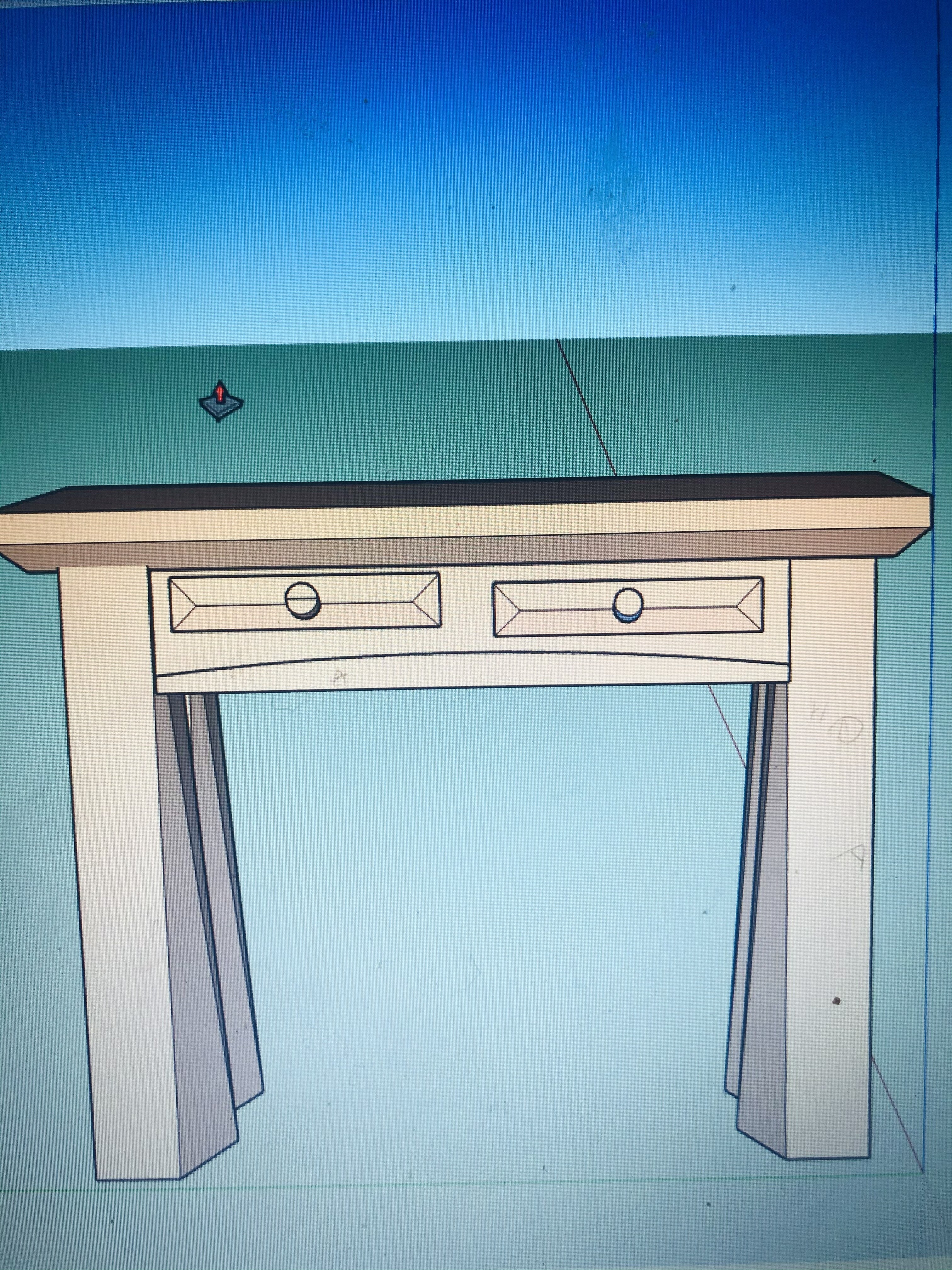

Hi I don’t know how to cut or push/pull the arch . I tried double clicking for the components to edit but it won’t give me that option either. I need help please.

From what I can see in your photo of your screen, The table is probably all one mass of geometry. The faces on the insides of the legs are angled and most likely when you try to push away the area under the arc, you are running into those faces on the legs which will stop Push/Pull.
Something weird going on with your drawers and knobs too.
Simon, it’s art. That’s a design feature. :wink:
It may be…
In that case I would make the drawers different size too. But maybe I am not artsy enough.
Ah… You have been using components so that’s good. You’ve drawn the arc outside of the apron component, though so the arc doesn’t divide the face into sections. Before you draw the arc you need to open the component for editing. Double click on it with the Select tool to open it. Then draw the arc, get the Push/Pull tool and push away the area under the arc.

i was having trouble exporting the photo but here is a better view
to answer your question I have a Lenovo PC which is Windows I assume?
here is my actual photo and I can’t seem to figure out how to cut the arch or push/pull it
Here I traced your arc while I had the component open. After I pushed the area under the arc I closed the component to get out of edit mode and deleted your original arc.

omg thank you so much, it worked!!
