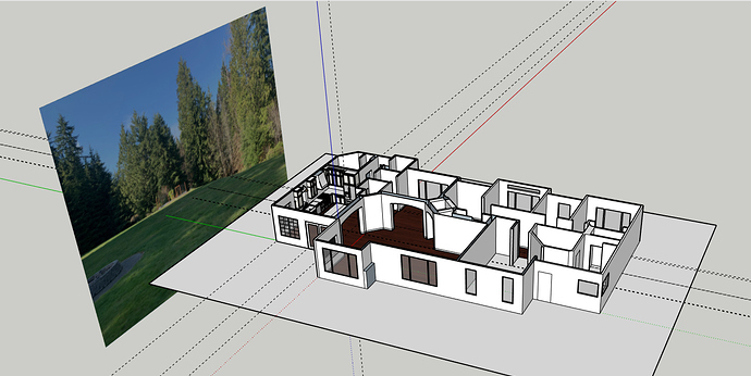

I can fix your camera to see your model but I haven’t found what’s causing it yet:
I’ll upload it when I do.
Snohomish Sketchup-cleaned.zip (6.8 MB)
Looks like there was a text entity at a huge distance from the rest of the model. Probably a label or dimension that had been linked to something you deleted.
