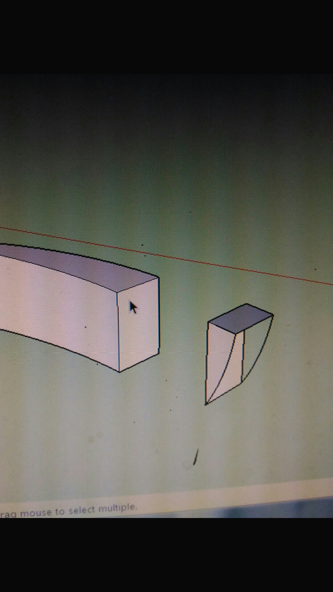

How to fill skin in this curved area? Ive used soap skin and bubble but it doestn help anymore

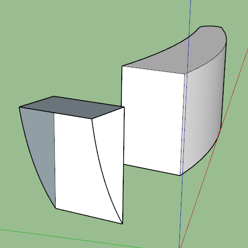

There are several plugins that will do this for you, Curviloft by Fredo6 is the first one that springs to mind.
But think about what it is you are constructing and you should be able to do it with native tools.
Here you see I simply scale the face and the curved section reshapes itself to fit.
Scale

Guessing from a photo of your screen makes it nearly impossible to know what you need.

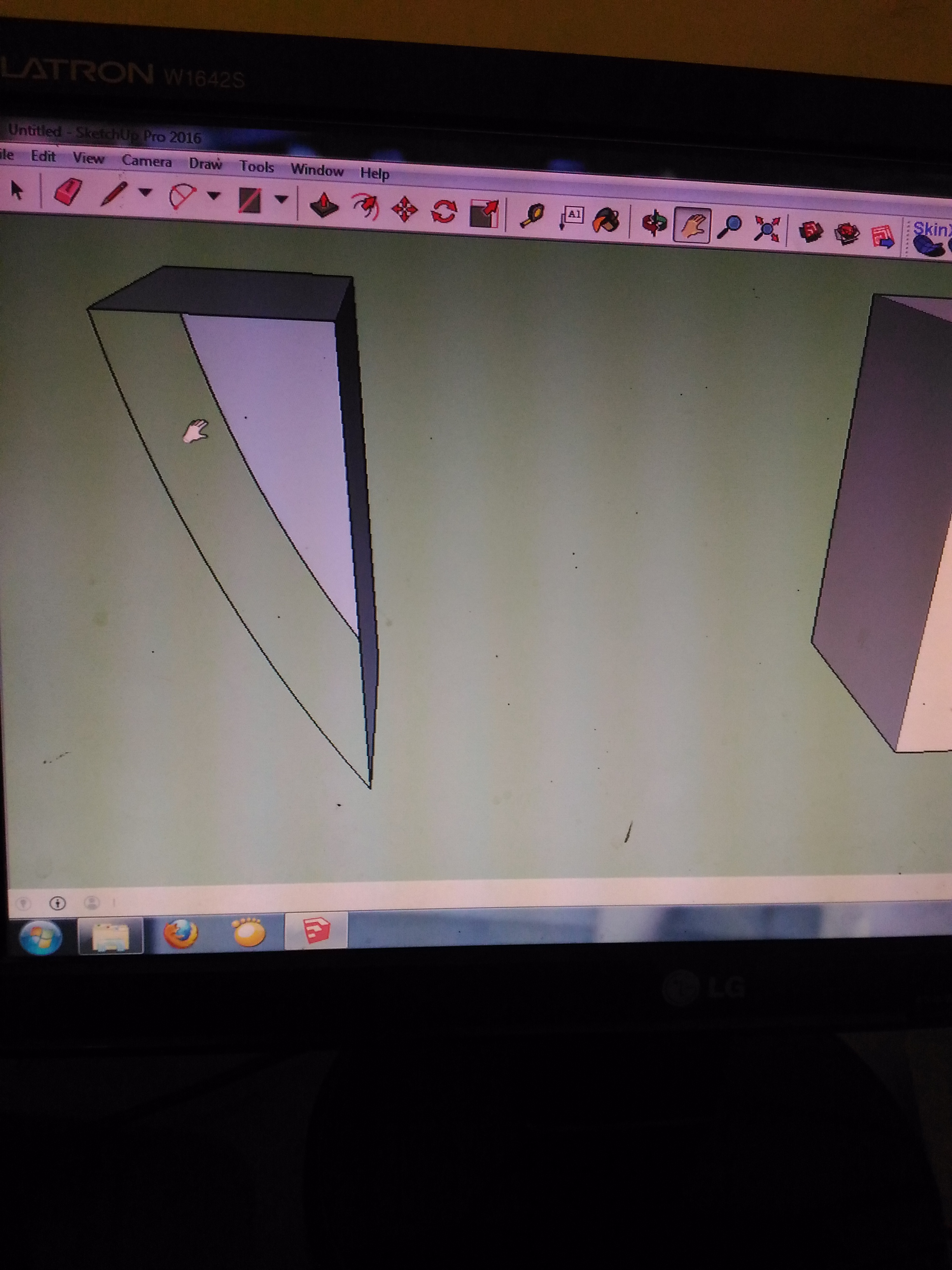

More view of mine
Attach the SketchUp file. Photos taken of your screen with your phone don’t help.
